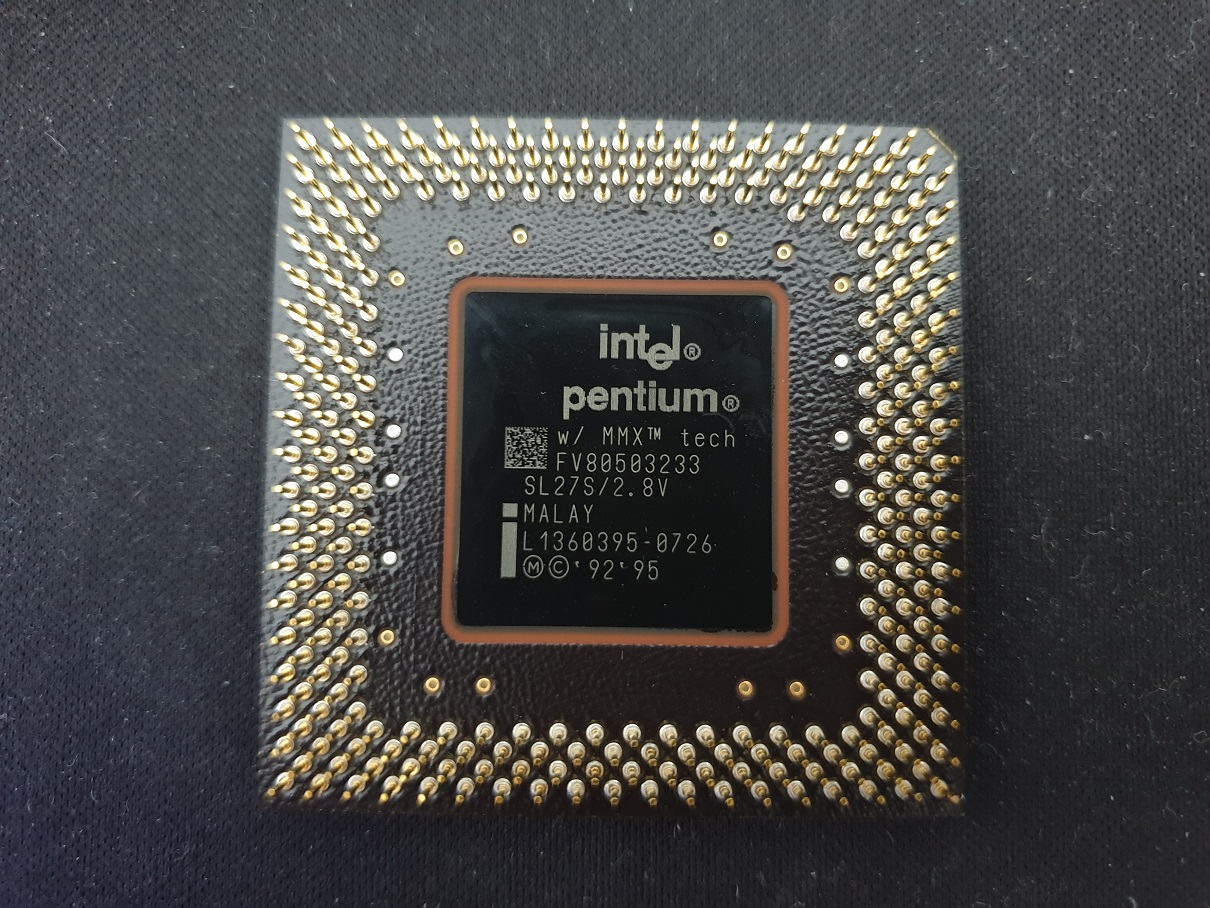

( edit2: i will try tommorow to gwt my p1 233mmx at 262 or 290 mhz with 75mhz or 83 mhz jumper, i hope it can do a difference in 3d games, i hope it wont destroy my dos games performance in my 6.22 dos partition 😀
If it's stable, it will be faster in DOS too. Be sure to test stability thoroughly at 75MHz before you try 83MHz. Note that biggest risk with this OC isn't CPU but HDD controller. If you run faster than the controller can handle, you'll get massive file corruption on your HDD(s). For that reason I'd recommend using a different OS install to test 83MHz (maybe clone the HDD if you have the tools), so you don't lose all your softwre if it can't handle it.
I'd say there's about a 99% chance the PIIX3 southbridge can handle 75MHz and maybe 66% chance it does 83MHz. I had an Asus P55T2P4 with same i430HX and PIIX3 that happily ran a K62+ at 500MHz (6x83MHz) with 512MB RAM (all cached because Asus did include a second tag RAM option). As for the P233MMX, it depends. Later revisions were massively over-engineered (or rather: artificially capped at 233MHz to avoid eating into P2 sales), so they could reach very high speeds. I'd give 262MHz >99% chance and 290MHz >75% chance. I once ran a late-stepping P200MMX stable at 350MHZ (3.5x100MHz) on a different board, and others went higher still. But as always with overclocking, YMMV. Worst-case you fry your CPU and board, garble your HDD contents and maybe kill the cat too. Realistically, I'd say HDD data corruption is the only significant risk (and that only at 83MHz). If the CPU can't handle it, the system won't boot - but it should be fine if you set the jumper back to stable speeds.
