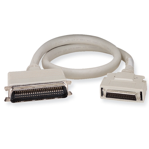

Will any SCSI-1 interface card work with this drive? Some of them have BIOS ROMs and others don't.
you only need the bios to be able to boot from a device, so no bios required...
unless you want to boot from that tape drive 🤣
(in which case you'll need a very special tape-boot enabled scsi bios rom for the card you'll be using)

The problem is availability, SCSI-1 cards are pretty rare here so I have to work with what I get.
Reply 25 of 31, by weedeewee
Miphee wrote on 2021-05-17, 17:32:
SCSI tends to be backwards compatible so, you can also go for a High end 64bit PCI-X 266MHz SCSI controller (allthough maybe not that high in specs) and hook the tape drive up to that with the necessary plug converters adapters/cables.

Reply 26 of 31, by Miphee
I just got an Ultra-SCSI card, would that work too?
Reply 27 of 31, by weedeewee
yes, and since it's narrow scsi, should be easy enough to find a cable that goes from the 50 pin connector to the centronics one.

Reply 28 of 31, by Miphee
Could you show me some pics of such a cable?
Reply 29 of 31, by weedeewee
Miphee wrote on 2021-05-17, 19:14:
No, but the internet can after a quick google.
google SCSI 50 pin to centronics
Do not ask Why !
Reply 30 of 31, by Miphee
Thanks, I didn't know SCSI-1 (that was made in the 80's) worked with Ultra-SCSI (~2003).
