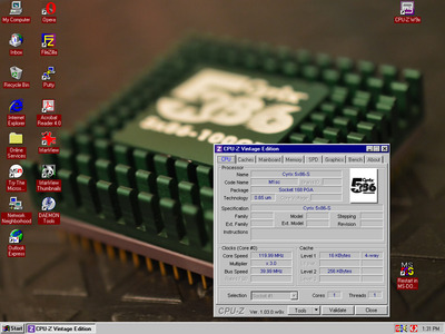

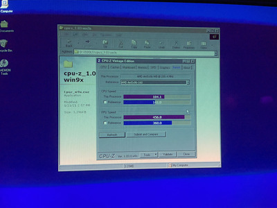

So I installed Win95C on my 5x86 system (it flies) and thought I'd run CPU-Z Benchmark on it. Surprisingly, it seems to be roughly on par with a Pentium 90! Anyone else tried this benchmark? Is this a good score?

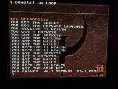

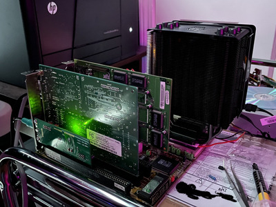

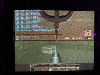

Hey guys, just wanted to share my excitement with hitting 200MHz “stable” in Windows with an AM5x86! Dropped the voltage on the 4v jumper down to 3.75 with a resistor, as Feipoa mentioned. That got me consistently running 3/4 through Phils Quake timedemo before crashing back to dosbench. Slapped the peltier back on at 5v and I was finishing! Booted into Windows98 and was able to complete timedemos in GLQuake, Quake2, SOTE, play some MotoRacer. This is at 50x4, I’ve not been able to get it stable at 66x3 on this LS486-d board. Still some condensation forming with the peltier at 5v so it’s still impractical but I’m glad I finally made it!

Glad to hear the parallel resistor helped your situation. I didn't have the right size trimmers, which is why I had to use a parallel resistor for this board.

Yes def appreciate it! If there is a trimmer you might recommend let me know, thanks!

If I recall, the mounting situation wasn't ideal. The resistors were surface mount and twisting of the screw will rip the pads. Also, there wasn't a suitable spot to glue the trimmer for support.

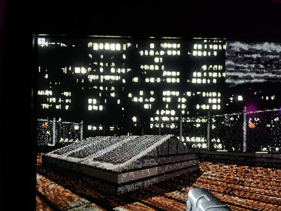

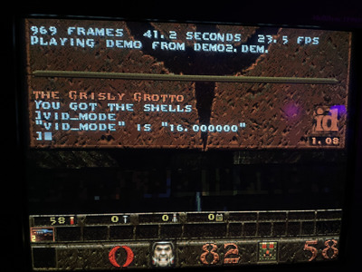

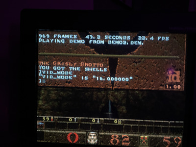

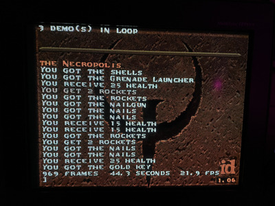

Well hell, to get 66x3 working all I had to do was drop down to a 32MB stick of ram.
21.9fps in Phils DosBench Quake Timedemo “option c”
Duke3D hitting 60fps on the roof top at 320x200
26.6fps in Chris SVGA 3D Bench
Impressive

@chadti99
I also noticed that Voodoo3 gets us +0.1 fps at 200mhz compared to MGA, but still a bit slower in Doom for example.
What ram you are using to be a problem for 200mhz.
