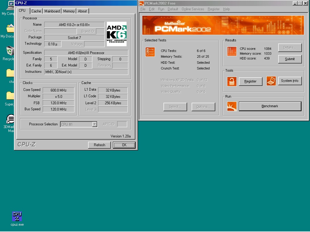

But I did run PCMark 2002 😀
The scores are not great but at least almost even with a PII 450.
No UDMA for the Pentium II neither for the K6-3+, the HDD performance is for some reason much better with the Gigabyte Ga-5AX. The exact same type of 40GB drive was used.
PII 450
K6-3+ 4.5x130
K6-3+ 5x120. Onboard cache activated.
K6-3+ 5x125
And when it comes to the Geforce 3 ti500 it performs just fine. I do not have any AGP drivers installed. Forceware 43.45.
K6-3+ 5x120 MHz no onboard cache.
