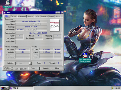

Here are results from my NexGen Nx586-P90:
file.php?mode=view&id=67538&sid=5e426d47ce56773e72d3c68cf0c5618e
Bench with idoff:
file.php?mode=view&id=67540&sid=5e426d47ce56773e72d3c68cf0c5618e
Bench with idon:
file.php?mode=view&id=67539&sid=5e426d47ce56773e72d3c68cf0c5618e
Most notable is that cpu-z sees a FPU, whereas the CPU has no FPU. Also the bench shows clearly that x87 emulation is used instead, most likely through win87em.dll.
CPU Frequency is correct.
L2 cache of 256 kB is missing.
idoff shows a noticable speedup in the bench.
Saved text file in attachment:

Reply 86 of 440, by CuPid
Here is a new version with several fixes :
- x87 emulation is not detected as an FPU anymore.
- UMC8881 support (for L2 cache).
I'm looking for testers with :
- UMC/OPTI 82C391/82C392, 82C481/82C482 and 82C596/82C597. The software may report erroneous information about chipset name & L2, but I'm interested in getting a TXT report.
- Ti SXL/SXL2 (again, I could not get mine working)
http://download.cpuid.com/betas/cpuz_w95.zip
Thanks !

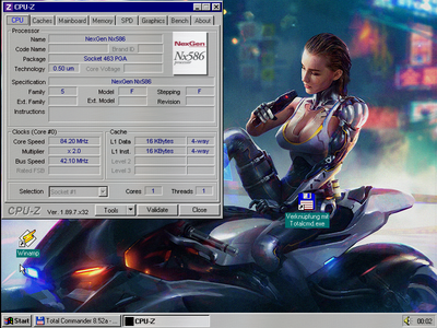

Reply 87 of 440, by elianda
Ok, the emulated FPU is gone.
Maybe for the instructions list 'NXOP' could be added?
file.php?mode=view&id=67643&sid=0b088a71154dab16e8a0fe340abece8d
file.php?mode=view&id=67644&sid=0b088a71154dab16e8a0fe340abece8d
nexgen.txt
3.87 KiB
59 downloads

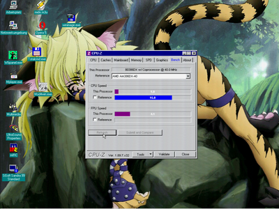

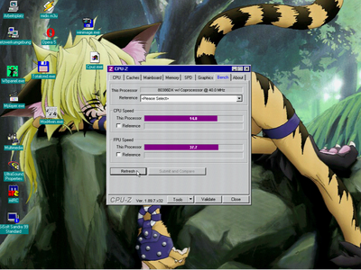

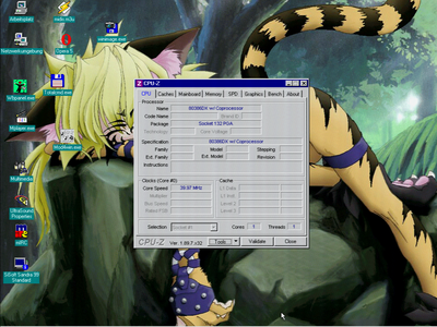

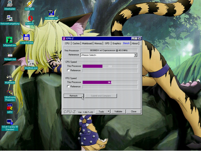

I have tested CPU-Z W95 on the Soyo SY-019I (http://retronn.de/imports/hwgal/hw_386eteq.html) with a 386DX-40 + i387-33 (at 40 MHz)
file.php?mode=view&id=67647&sid=0b088a71154dab16e8a0fe340abece8d
file.php?mode=view&id=67648&sid=0b088a71154dab16e8a0fe340abece8d
With Turbo-Off:
file.php?mode=view&id=67649&sid=0b088a71154dab16e8a0fe340abece8d
Remarks: CPU benchmark shows a factor 2 lower performance than the profile data for 386DX-40. My system is performing ok.
Is the benchmark memory intense? Maybe it benches swapping instead of actual the CPU?

Reply 90 of 440, by CuPid
@bakemono : thanks, this can indeed be very useful.
@elianda : thank you for the test, I think there is a way to tell if a 386 is Intel or AMD, if this is the case I'll add a fix.
the benchmark is a simple dhrystone/whetstone. AFAI could see, the dhrystone score varies with the cache hierarchy, but not much with memory speed (maybe more on 386 w/o L1).
No luck with the Eteq, no information is read at all 😢
I need a vacation.
Reply 91 of 440, by elianda
Ok, my 386DX-40 shown here uses 64 kB L1 cache on the mainboard. With what config the reference 386DX-40 score was measured? Even if one increase cache to 128 kB it does not result in doubled Dhrystones.
Currently for me the main limitation for my 386/486 systems is that CPU-Z requires Win9x which prevents me testing on more systems.

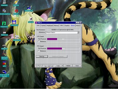

Reply 94 of 440, by elianda
The timers are good. The issue is that the Dhrystone routine you use is extremely sensitive to enabled/disabled cache. Of course disabled cache gives a performance hit, but not like 50% performance on typical applications.
So my 386 system has 32 MB RAM where the first 16 MB get cached due to chipset limitations. I did the benches again with limiting RAM in Win95 to 16 MB using HIMEM 2.77G instead of 3.09.
Cached:
file.php?mode=view&id=67657&sid=0b088a71154dab16e8a0fe340abece8d
Uncached:
file.php?mode=view&id=67658&sid=0b088a71154dab16e8a0fe340abece8d
I repeated the bench several times to see if it shows really stable.
So disabling cache drops the score from 14.8 to 6.3 (42.5%). Seems overestimated.
