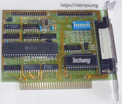

I have a IBM clone look a like, which for me is fine..
Machine will get a 8Mhz Turbo motherboard. Think got 640KB +384KB memory
Will have a 4 way techway high-density floppy controller.
I dont going to use full height drives, because the space that i would get to use half-height drives means lot to me..
Got a 80MB scsi 5.25inch HDD from Seagate.
Then got 3 half height spaces left. ( i dont have blank plates to cover the empty un-used holes)
Think to use two 5.25 inch 360KB floppy drives.. Why.. First it was the standard back ten.. Second, when ever cant use an HDD anymore (yeah i know of XT-IDE, but like more the old style)
First 360KB would be use as boot drive, so i wont even have to remove the boot floppy from it when i have a second 360KB drive.
As third drive (just for compatible sake and easier data transfers) a micro floppy 3.5 inch 1.44MB.
Then i have to install them on the Primary part of the controller and ONE drive on the Secondary IDC of the controller.

Reply 5 of 15, by weedeewee
Interesting. I wonder how they do more than 2 drives on that card when the main chip only does 2.

Reply 7 of 15, by Robin4
weedeewee wrote on 2024-04-21, 20:59:
Maybe the main controller could do actually 4..
Yes 2 drives where the most used.
But with a IBM XT CLONE.. you have (if you use half height drives) 4 spaces to install drives in.
That changed when the IBM 5170 came to the market.. And only mostly had 2x 5.25 external, and sometimes with 1x 5.25 internal low above the bottom of the case.

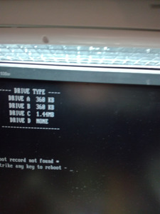

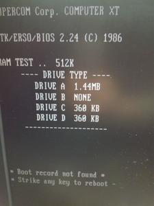

I got the 4 way drive controller working.
The rule of tumb here is, you cant skip drive C: if you want the 1.44MB drive on the secondary IDC.
So you would have A: B: and D:
Its only possible to do A: B: C: so HDD would be probably D:
If you install a fourth drive.. HDD will be E:
Thought i had to install a driver for drive 3 and 4.. But that was not how it came out.
Drive A: and B: needs to be on the same cable on primary IDC.
Drive C: is on secundairy IDC.

Find out that you also can do this:
So the 3.5 inch 1.44 MB drive just cant work on a single drive cable in the middle before the twist comes?
Does these 3.5 inch 1.44MB drives also have termination and should it be possible to disable that?

Reply 11 of 15, by Horun
Robin4 wrote on 2024-04-21, 22:28:
Most 3.5" newer floppy drives are locked at second ID for "A" after the twist, some have jumpers that you can change to first ID and put it middle before the twist and be A drive.
Most newer are auto terminated, those with jumpers might have a Term enable jumper but most are auto....
added: Your Panasonic JU-257 should have jumpers or switches. If switches it is sw3 that sets the ID...only the ones with jumpers have a TM term enable/disable, the ones with switches do not.
I cannot find the exact JU-257T234

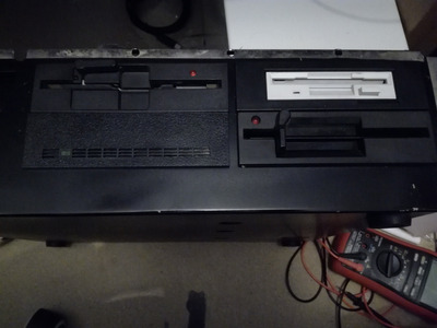

Reply 13 of 15, by BitWrangler
Just mentioning there are two options to get three floppies in one full height/two-half height bays...
A two in one 3.5 and 5.25 drive... rare, gets you two drives in one half height package, I guess technically if you have hundreds of bucks to blow and a horseshoe up your butt you could find and buy two and have 4 floppies in the height of a full height bay.
Third height 5.25s, which exist for low values of exist, also quite rare, think they were for one of the Compaq portable. Third full height which makes them 2/3 half height. Maybe there are brackets obstructing a fitment across two half bays in some systems that make things difficult. Anyway, two of these types of 5.25s and 3.5 adapters are available where the 3.5 is at the bottom more or less, and it's all faceplate above the drive, which you'd have to trim down to make the 3.5 assembly also third height.
Then also For super7 and slot 1 and later systems, you may find you can get a 1.2MB 5.25 that is a bit more slimline behind the faceplate and squeeze a compact USB floppy into it also, either connecting with USB internally or by hacking it to take regular interface. There's also some slimline drives built into "media bay" 3.5" drives that have floppy and card readers, but it's kind of a shame to spoil one of those to hack the drive mech out of it, unless it's had some weirdly specific damage to the card reader part.

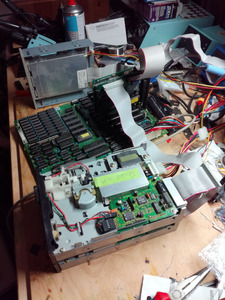

Reply 15 of 15, by Robin4
I thought about this question..
Is it true that the drives on the left side have to removed first before you can remove the units on the right side?
Also found out that the right side have more screw holes on the bottom.. (yes it was designed like so that the motherboard is otherwise in the way?
A also think that a heavyer HDD would be much more secured on the right side of the cage then on the left side..
So probably it would be better to have the two 5.25 inch drives on the left side..
Then on the right side on the the 5.25 inch bracket to 3.5 inch for mini floppy drive and on the bottom the half height HDD or HDD 5.25 inch to 3.5 inch bracket.
