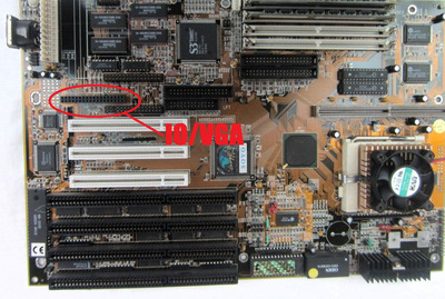

Hello everyone,
I'm totally happy because I got another Socket 7 motherboard with the great HX chipset today. A good friend of mine gave me a SOYO SY-5TS5 - everything works perfectly.
I noticed that the board has an S3-Trio64V+ on it, but unfortunately my friend no longer has the correct IO/VGA connector.
287.82 KiB
308 views
Does anyone know the motherboard and have information about the pinout of the connector? I would be very happy for any help!
Kind regards and many thanks in advance 😉

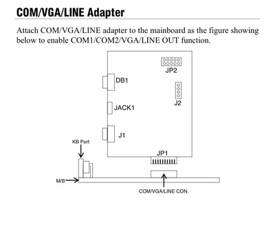

Reply 1 of 7, by PC@LIVE
I checked the manual, and I think it's a rather particular card, the one you're missing.
I photographed you, the pages where there is the description, I don't know if it can be useful to you in some way, but perhaps it is possible to see which VGA pins go to the connector, however I don't think it will be easy to understand something about it, without the help of someone who understands enough.

Reply 3 of 7, by JF_Sebastian
PC@LIVE wrote on 2024-04-25, 19:52:
Thanks for your reply. I found that document, too but unfortunately there are no information about the pinout 😉

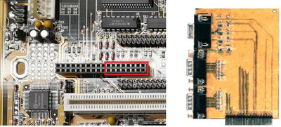

Reply 6 of 7, by PC Hoarder Patrol
Not that it helps much, but this is about the best pic I could find of the breakout card (seems to differ from the manual where not all the ports are hardwired). From the traces it looks like the (approx) inner 16 pins on the m/b connector are for vga.
There are a few posts elsewhere from the late 90s asking the same pinout question - none got an answer (seems Soyo were no help at all!)
132.15 KiB
179 views
