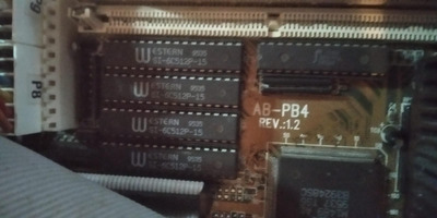

Hi, im building a 486 PC for my personal collection, and i chose a AB-PB4 motherboard. Is not a bad one, exept some problems works very good, and support my Cyrix 5x86 100mhz CPU without problem
One thing i really curious is about L2 cache, now have 256kb
94.04 KiB
525 views
I did a lot of test and i found the speed gain is almost nothing, for example, Doom without L2 cache give me 67.2fps in a timedemo, and 68.1 in same timedemo with cache enabled! is like nothing! 3dbench, pcbench, quake, etc give me the same, almost nothing difference
im surprise, because in other 486 motherboards i have, L2 cache give me from 10 to 15% differences
Anyways i decide to disable L2 cache, because sadly did not work well if i overclock cpu to 120mhz, the system hang in boot or loading a game or program, but still want to talk about what can happen to the cache... and one more thing, someone knows if a faster cache will work fine wth CPU at 120mhz?
thanks

I'm not sure whether this chipset is able to do an ideal 2-1-1-1 burst on 40 MHz with a single SRAM bank...
You have 256 kB L2 cache in a single bank with 4 64kx8 modules + 1 32kx8 tag.

I am quite sure, that there is no "Western" brand for SRAMs, so it must be fake cache.
The tag ram is not visible (way too blurry) on the picture.
Hi, the tag say 71256 SA15TP E9533P
Sadly i dont have cache on other motherboards that are -15, the fastest one i have is -20 and at 120mhz not even boot, but like i say to weedeewee i think is real because cachechk can test it
Disruptor wrote on 2024-04-29, 20:27:
I was thinking about this, because i use 2-1-1-1 and 40x3 for 120. If i use 3-1-1-1 L2 works fine, but speed penalty is too much

theelf wrote on 2024-04-29, 22:11:
I read exist -10 cache ram, but i think must be impossible to find right now
I just use regular -15 chips, though not every single one of them can do it. I tend to use 96/late 95 Winbond and UMC chips from the 512kbit variety, they tend to work just fine at 40MHz 2-1-1-1 in several different boards here, should they be single or dual bank ones. OTOH my only 1Mbit set (also 15ns) definitely falls short here.

Ok, yes, after some test i can confirm, at least in my motherboard AB-PB4 and with Cyrix 5x86 at 100mhz - 33mhzx3, L2 cache is almost useless. I tried 128 and 256kb different cache ram, from other motherboards and the speed difference in from imperceptible to none
I have a IBM PS/1 486 DX4 and cache make a big difference, a 486DLC and same, but here is like cache did nothing, and i can confirm the cache i test is working fine in other motherboards
maybe i will find new cache that works with 40mhz bus some day and test again
Sadly I only one -15 set, all others are -20 and both fails in 2-1-1-1 and 40mhz in my PB4. Shame! hope i will find new cache soon to test
