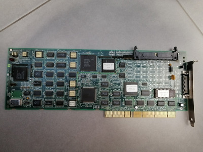

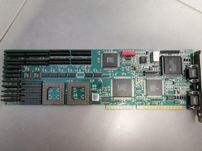

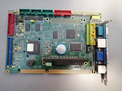

Reply 41564 of 48711, by Turbo ->

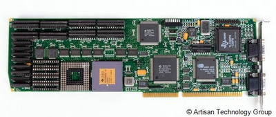

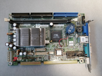

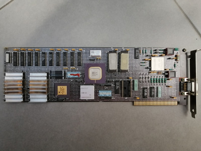

Got some interesting cards in the last few weeks. Maybe someone here can say more about them.
Reply 41565 of 48711, by TheMobRules
Turbo -> wrote on 2021-12-18, 21:20:
#2 seems to be some kind of graphics card (notice the AVGA1 and Number Nine chips), but it's not a standard VGA, probably some type of accelerator or professional equipment?
#3 is clearly an Adaptec AHA-1740 EISA SCSI controller
#4 and #5 are ISA SBCs that you can plug into a backplane
Not sure about #1 though

Reply 41570 of 48711, by Grzyb
TheMobRules wrote on 2021-12-18, 21:50:
Number Nine GXi
AVGA1 a.k.a. CL-GD5401 provides VGA compatibility
the lacking chip should be TMS-34020, ie. TIGA graphics coprocessor
overall, one of the most powerful graphics cards for ISA
38.5 KiB
397 views
Reply 41571 of 48711, by Turbo ->
Grzyb wrote on 2021-12-19, 07:22:
Will the card work without the chip? What is the other socket on the left side reserved for?

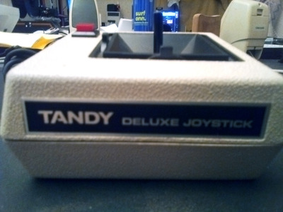

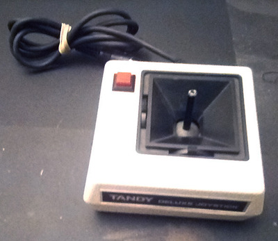

I love my Tandy 1000hx. I've been slowly getting accessories and peripherals for it (like the printer above); a CGP-115 plotter, A deluxe mouse, and I've been keeping my eye out for a bargain on a Koalapad.
I've been wanting to get a joysick for it, but they're holding out at a bit more than I want to pay (just a bit...) I've considered making a PC joystick-to-T1000hx adapter, but I don't want to risk damaging my T1000hx.
So when I saw a joystick for sale for about half the going rate on ebay... I grabbed it.
Wasn't til I'd already paid for it that I saw that the tip of the stick was broken off.
Rather than become gloomy, I decided to design and 3D print a joystick cover for it.
(I'll post pix of that once I get it done...)
So... to paraphrase John McClain at this festive time of year... "Now I have a joystick... ho ho ho".
67.28 KiB
351 views
far-shot of tandy joystick (see the tip cut off?)
167.34 KiB
351 views
close-up of tandy joystick (see the tip cut off?)

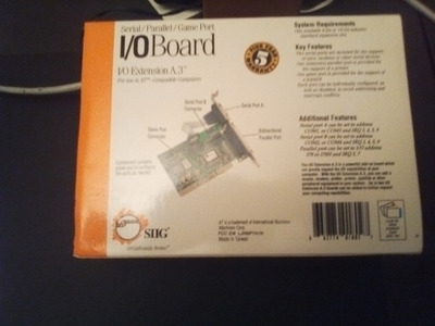

Reply 41579 of 48711, by Hamby
I saw this ISA I/O board on ebay at what seemed a reasonable price, and so I grabbed it for future builds. It was complete in the box with all documentation, etc.
One thing I'm curious about... it has a gameport/MIDI port. My sound card also has a game/midi port...is there a way to adjust the IRQs and other settings to use both without conflict? I can't think of a single game that would use 4 joysticks, but I could use one for joysticks, the other for midi.
158.96 KiB
692 views
SIIG multi-io board with serial, parallel and game ports
143.95 KiB
692 views
specs and info on the SIIG multi-io board
