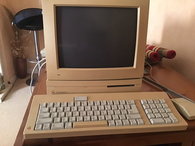

SteveC wrote on 2022-08-30, 12:59:
Just won something a bit different for me (seller's photo)
A complete Apple Macintosh LC that is dead... be a fun little project!
Buying computers that are dead is a great way to get a deal. Many won't touch it, and good chance it's not a major repair.
I bought an old Prolinea that was completely original for very little, and all that was wrong was a shorted tantalum.
Reply 46141 of 57151, by liqmat
eesz34 wrote on 2022-08-30, 14:48:
Yep, sometimes you get lucky. I bought a "non-working" 1980s electronic handheld game with original box for peanuts. Opened it up and found one small flake of solder shorting two legs of an IC. Blew it off and it came back to life. I also read about a guy who bought a "non-working" Vectrex console for cheap (working units are expensive) and all he did was reseat the roms and it came back to life.
Had an eye on that as its very local. Glad its gone to someone likeminded! I have no idea about apple stuff but it could be an interesting project.
Well, 68K macs tend to have battery explosions so unless you can see under the cover you are taking a gamble.

Unknown_K wrote on 2022-08-30, 20:05:
If it's not that, then it's most likely leaking caps on the PSU, which is very common with the entire LC lineup.

LewisRaz wrote on 2022-08-30, 19:47:
Yeah I'm not far away! I have no idea either on Apple stuff, especially that age! Proper gamble as no pictures of the internals, but for £30 if either the base unit or the screen work then it's worth it, but hopefully it's fixable as I've never used an Apple of this vintage 😀

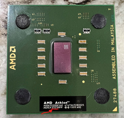

TrashPanda wrote on 2022-08-30, 22:02:
Its all good, the board is dead till I can be bothered repairing it and its been replaced by a Abit NF7-S with a unlocked XP3200+ Barton (One of the rare ones with the pads still in place, later ones had them removed, now I just need to look up the pencil mod for it)
Pencil mod does not work on Bartons and is also not necessary.
They either come locked and can't be unlocked or they come unlocked.
You'll need one with production date 0339 or earlier. It's written on the black label. Second row.

Reply 46152 of 57151, by TrashPanda
RaiderOfLostVoodoo wrote on 2022-08-31, 01:34:
Pencil mod does not work on Bartons and is also not necessary. They either come locked and can't be unlocked or they come unlock […]
Don't really need Uni AGP with this type of board either as any AGP card going into it will be 8x and anything not 8x will be slower than what this CPU deserves, though I can see Uni being useful for a KT400 board with a XP2400+ in it.
There are no KT400 boards with universal AGP. KT333CE is the last chipset for AMD CPUs which can run AGP 3.3V cards.
In theory a Pentium 4 would be even faster, but it's well known that their cooling is problematic and you would have to stick to a shitty chipset. So KT333CE is usually seen as the better choice when it comes to maxing out a platform for Voodoo5 5500/6000.
I've been looking for an EPoX 8K5A3+ (which is seen as the holy grail for V5) for a year now. Haven't seen a single one yet. 🙁 Neither overpriced nor broken. So I have to stick to my MSI KT3 Ultra2 for now.
This is the XP3200+ CPU I have.
Week 0319 production date, AQXDA Stepping, 400 FSB model.
Got a bunch of extra pads on the substrate not present on later models, im guessing that was how they locked these CPUs ?
Im curious what the pads do exactly.

Reply 46154 of 57151, by TrashPanda
RandomStranger wrote on 2022-08-31, 05:16:
TrashPanda wrote on 2022-08-31, 02:32:
I always assumed they are to prevent damage to the crystal from the cooler.
/facepalm - I should really try to be more specific, sorry about that.
Meatball posted a pic .. youll notice the little numbered blocks of contact pads on the substrate .. not the soft felt pads 🤣
I understand that we do get some uhh people here of questionable intellect but I dont think I fall into that category just yet... dementia hasn't quite got me so I think I figured out what the felt pads were just by looking at the CPU 😁.
The numbered blocks of tiny contact pads I guess possibly served as a way to test CPU functions, I know earlier on models you could use a pencil to bridge them to unlock multipliers.
Its why I was under the impression Barton needed the same trick.
