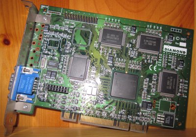

Bought some cache and a Riva128 PCI from a local market. Unfortunately the card does not work in the machine it was intended for... the P66.
wrote:Bought some cache and a Riva128 PCI from a local market. Unfortunately the card does not work in the machine it was intended for... the P66.
Any idea why it doesn't work? Does it need Pentium 2 and/or MMX maybe?
1982 to 2001
Maybe PCI ver 1.0.... or (0.98 beta 😁 ) with no 3.3V ???
Edit: ohhhhh, I'm wondering if that's how I ended up with an ISA card in my P60....
wrote:Maybe PCI ver 1.0.... or (0.98 beta 😁 ) with no 3.3V ???
EDIT:I had forgotten that, that is a more likely option. The card has both 'indents' so it should work with only 5v? I'm not sure

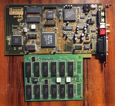

Bought these beauties on a local trading site:
I haven't tested it yet, but I think that's a 24MB memory module.
Both are in near mint condition.

Them's 1M x 16bit EDO chips and you got 12 of them, so 24MB no doubt! Wow that's rare. I wonder why the board isn't colored in gold.
wrote:wrote:Bought some cache and a Riva128 PCI from a local market. Unfortunately the card does not work in the machine it was intended for... the P66.
The card has two notches so it should support both voltages... it's old enough. Can't imagine that the firmware checks for Instruction Set support... highly unlikely.
The reason for it failing could have to do with "bus-mastering capabilities" which seem to be required... but take this with a huge grain of salt!
The card works on the LS486E though, which refuses to work with the Radeon 9250 for example. I hope that it will also work on the HOT433 as I really dig the Riva(even more so the TNT albeit former seems more fitting in regards to the classic era).
