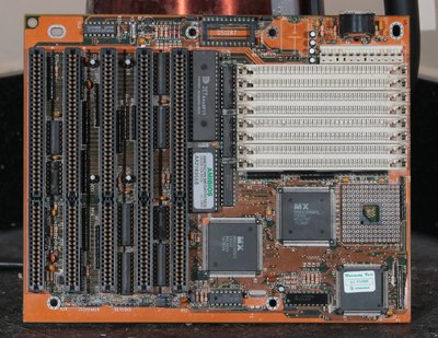

A few weeks ago I bought some corroded motherboards from someone local that I've bought from before. There was a 386 board, a 486 board and a 286 board. The idea was to get the 486 board up and running, but that one has a keyboard controller problem and I've put it away for now.

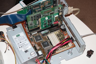

In the lot was a 386 DX 40 motherboard with no cache, I can't identify it but I can kind of work out what's what on there. It for some reason uses a DS1287, which wasn't present at all and the socket for it was damaged. It didn't boot and just went through a couple of post codes very slowly, eventually just doing nothing.
The attachment 386DX40-with-DS1287-1.jpg is no longer available
I reinstalled a socket for the DS1287 and ordered some DS1287s from a chinese seller - once they arrived, I plugged it all in and now the board boots! Hooray!
I had to resolder some traces for the keyboard and it doesn't seem to work with one of my PS/2 keyboards, but it works with the Cherry keyboard so that's okay.

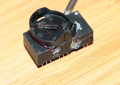

Except it can't keep BIOS settings, it won't use an external battery when I plug it into what I think is the battery header. These DS1287 modules have date codes of 1990 and 1992, apparently down to 0.2 and 0.6 volts respectively.
Thankfully I have a dremel and there are lots of YouTube videos showing how to cut into the DS1287 to put on a coin cell holder:
The attachment 386DX40-with-DS1287-2.jpg is no longer available
My test setup with the upgraded DS1287 fitted:
The attachment 386DX40-with-DS1287-3.jpg is no longer available

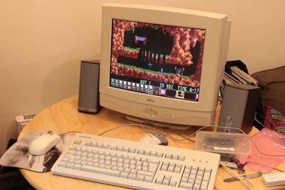

Now the keyboard, disk controller, mouse, sound, video all work, excellent 😁
The attachment 386DX40-with-DS1287-4.jpg is no longer available
Does anyone know what board this is? I'm wondering what the SLC1 socket could be for and what some of the jumper settings are

The socket could be for a 387 Math Co-Processor or FPU. AMD Am386-DX40 is what I see on there, so a good late 386 board. Happy to see older boards work once again and this makes me want to build a 386. Might build a 486 machine soon, but I have no money right now at the moment (unemployment sucks).

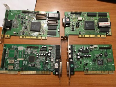

Got some random things this past weekend.
ATi mach 64, S3 virge DX, Yamaha A151-A00, ESS Solo-1 (ES1938S)

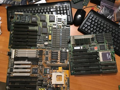

Motherboards, S7 board boots but no working keyboard. The 286 and 486 boards need to have battery corrosion removed before testing.

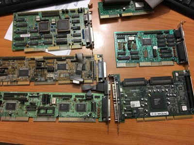

Some controllercards, two ISA, two VLB, one ISA SCSI-controller and an PCI-X one.

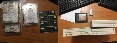

Some SCSI stuff, 512MB ECC REG Sdram, and lntel overdrive removal kit.
The harddrives seems to be NOS, compaq 9,1GB 10K Ultra wide.

The empty socket is for 387 co-processor. Not necessary, but optional.
