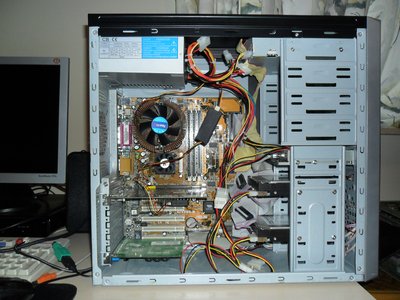

Reply 14125 of 53069, by brostenen
kithylin wrote:
Win9x won't work with any sort of raid anything even basic raid-0. It just won't, there's no way around it.
Raid using SATA-HDD's right? I have had zero issues with both Raid-0 and Raid-1 on my Asus A7V266-E setup.
That is however PATA and not SATA drives. There is a seperate BIOS for raid. Making it hardware and not software Raid.
I am running Win98-SE on this box.
Spec's:
- Asus A7V266-E
- AthlonXP 2400
- 512mb PC133
- 2 x Seagate 40gb 7200rpm drives
- Compaq Voodoo3-3500
- Yamaha YMF-724

Reply 14128 of 53069, by kithylin
brostenen wrote:
Raid using SATA-HDD's right? I have had zero issues with both Raid-0 and Raid-1 on my Asus A7V266-E setup. That is however PATA […]
Spec's:
- Asus A7V266-E
- AthlonXP 2400
- 512mb PC133
- Yamaha YMF-724
I've tried every possible RAID setup under the sun and none of them work 100% natively-stable with vanilla Win98se. I've tried 3ware IDE raid cards with it's own bios, I've tried SATA raid cards from adaptec, I've tried SCSI raid cards from 3ware, LSI, adaptec. I've tried Promise PCI IDE raid and SATA raid cards, I've tried AMI / American Megatrends PERC SCSI cards.. I've tried promise, via and nvidia onboard raid cards on motherboards.. none of it works. Either the exported array / virtual drives don't even show up under ms-dos for partitioning. (booting off the win98se CD-ROM to prepare it for installing the OS) Or they do partition but fail to format. Or they do partition, do format, and setup hangs and locks up on copying files.. or the few that have made it through setup either hang and lock up, or crash or if it does make it to the OS it'll bluescreen and fail. Or are some that I've managed to get working all the way to desktop are so ungodly terribly slow that a single IDE drive is faster.. just all sorts of "Weirdness" that ain't good.
In general Win9x doesn't work with raid. It's not worth the headache when you can just stick in a fast 7200 rpm IDE drive and go. And can get those off ebay for like $10 or less in good shape.
Most Win98 builds are generally for stability and just working period more than speed. At least on the storage side. If you really want speed use a single sata ssd in a single sata-to-ide and just go with that. or a CF card in CF-to-IDE is overkill for win98.

Reply 14132 of 53069, by brostenen
Shure there are raid setup's that do not work in Win98se, mine however is working flawless in vanilla Win98se.
As I wrote. Both Raid-0 and 1 are working. There are a seperate jumper for enabling the Raid BIOS and if I
connect drives to the non-raid controller, they will net be used when the jumper is in Raid position.
I know they are working, as both drives are writing or reading at the same time, when placing my ear to the drive.
Most early 00's motherboard that had raid build into the main BIOS, were boards that I had problems with.
My silicon image ata-100 Raid PCI card have its own problems. It can not run raid in both 98 and XP.
Some early to mid-00's motherboards have problems running raid too. I have only tried it in XP though.
That all said. The Asus A7V266-E has no problems with Raid in vanilla Win98se. (I have not tested it in XP)
Some boards need the driver or raid program to be installed too. As they are software Raid.
Just keep that in mind, as it is not allways enough just to set an Raid array in the BIOS.
You need the drivers and programs to be installed in Windows too. Raid is in other words a hit or miss.
Reply 14133 of 53069, by kithylin
brostenen wrote:
Shure there are raid setup's that do not work in Win98se, mine however is working flawless in vanilla Win98se. As I wrote. Both […]
Yep.. and more miss than hit. And you've managed to find the -one- magical raid configuration that works with win98, congrats. In general I'll always continue to suggest -against- raid with win98 to everyone.. it's just way too much of a headache to even bother with it when there's cheaper and easier ways to do it.
