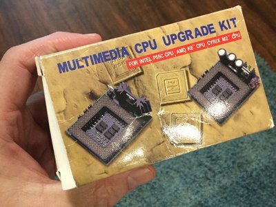

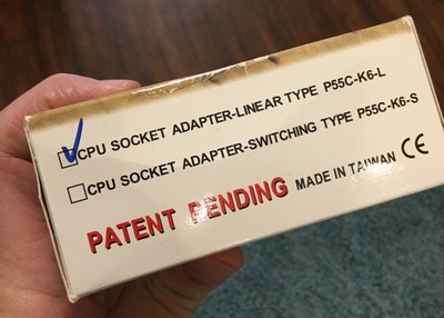

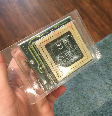

I got some sort of CPU adapter in that massive PPro haul a few weeks back new in box. Have found two of these so far, but not quite sure what adapter it is.

My 2 cents: possibly a Socket 5 to Socket 7 adapter to allow the use of the Pentium MMX or K6 processors (correct me if I'm wrong here).

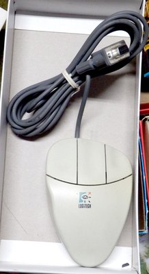

Logitech 3 button serial mouse. Takes me back to 1993
I hate meeces to peeces !
Either this or a single-voltage Socket 7 to split-voltage Socket 7 adapter. Maybe the adapter covers both use cases. P55C is the Pentium MMX and K6 is its counterpart from AMD. Unfortunately this has a linear voltage regulator. I guess that's why it says "K6-L". The regulator will get fairly hot if you put a K6-PR200 in it and you don't let fan blow directly on it.
More or less 😉
Thing is, the difference between So5 and So7 is that So7 has a second multiplier pin and the possibility to use split voltage. If you're not using that second multiplier pin and your board doesn't support split voltage, So5 and So7 are completely identical, so you don't need any kind of adapter. So the So5 vs So7 bit isn't relevant. What is, is the voltage, and that's what this adapter does: it supplies 2.8V (and possibly other voltages too) with a split-voltage plane, so you can run split voltage CPUs (such as the P55C Pentium MMX and K6) on a motherboard (either So5 or So7) that only has a single voltage plane. Looking at the jumpers it probably also allows modification of the multiplier, to allow 2.5x and 3x (and maybe higher if it also implements the third multiplier bit) on an So5 board.
