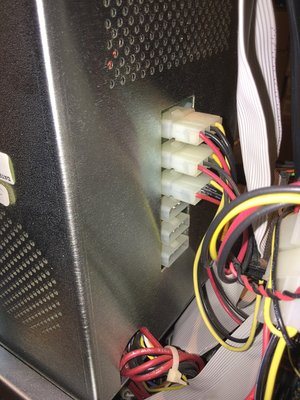

Last, but not least. I find this advanced for its time. A modular power supply in an old system like this.

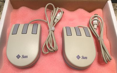

That's it for now... oh wait... and I even found a gift for my wife who was a Sun Solaris admin for many years.
Two brand spanking new unused Sun three button meeses. (sic)

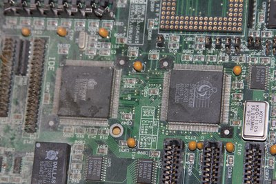

Received some "challanges"
486 with "Symphony" chipset - never heard of that.
1.67 MiB
1194 views
1.43 MiB
1194 views

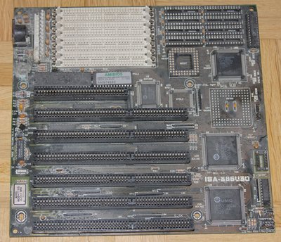

ISA386U30 - looks like ASUS?

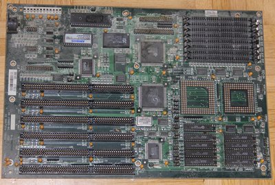

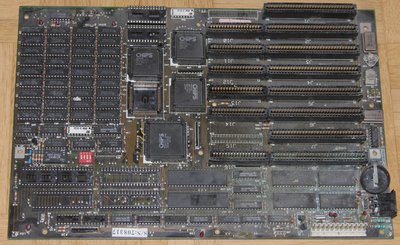

interesting 80286:
1.6 MiB
1194 views

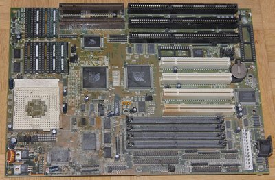

486 with VLB and PCI:
1.45 MiB
1194 views
interesting 80286:
Think they will get a bath first...
That ISA386U30 is definitely Asus.
The 486 with VLB & PCI is a nice one, since it has on-board floppy & IDE and also appears to have a PS/2 header next to the keyboard connector.
Looks like you're missing a BIOS chip and some cache memory chips.
This should be solvable, but also 1 crystal missing (bright spot in the middle) and the corrosion looks rather heavy...not much hope for this one at the moment.

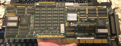

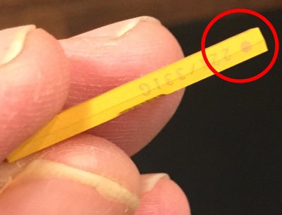

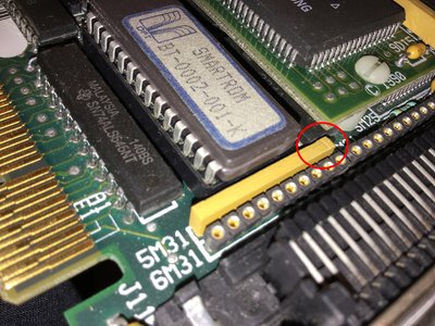

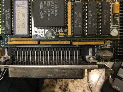

Yes, Luckybob and I, like two old guys on "This Old House", linked up via Discord video to discuss this machine. We were both impressed with that EISA full length SCSI controller, but Luckybob noticed the resistor packs were missing on the back of the card. Luckily, the previous owner had taped those missing resistors to the computer case. Luckybob had dealt with an old SCSI controller like this one before and I had a hard time finding which direction that they plug in. I saw that each resistor had a small dot on the top to indicate pin 1, but nothing on the SCSI controller to show where pin 1 should face. Luckybob asked me to look for a resistor nearby that might have a notch or groove in it, since there were none with a similar dot. Sure enough there was a resistor that had that notch in it and that told me which direction to put the other three resistors.
The controller.
962.1 KiB
1494 views
The dot.
528.97 KiB
1512 views
The notch.
987.04 KiB
1512 views
Success.
952.57 KiB
1510 views

Brother, you are right on the money about the SCSI controller. It has 4.5MB of cache memory which was just amazing in 1991-92. The controller has a date stamp of 1991.
