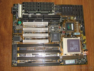

Only photo from seller, this board is on the road to me for 10 Euros 😀 Ram and processor included
    150.69 KiB
    392 views
Soyo 019R1 AM386DX 40MHz, 8Mb ram, 512Kb Trident 9000 Graphics
S26361-D756-X Intel i486DX 33MHz, 4Mb ram, 512Kb - 1Mb graphics on board
Reply 28219 of 40040, by Intel486dx33
Nice board.
Why would you want VLB slot if you have PCI ?
Unless you have a VLB video card you wanted to use.
