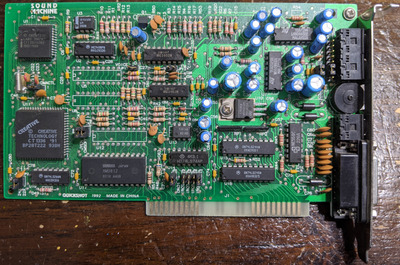

Reply 33225 of 53165, by mpe
The Sound Machine is a Quickshot branded CT1350. It is the same thing except for missing CMS upgrade sockets. More a custom branded version rather than a clone.

Reply 33226 of 53165, by dionb
luckybob wrote on 2020-04-01, 21:21:
am I high, or does that Sound Machine have a "real" creative clpd? not to mention a 1:1 copy of the PCB?
If you're bored with lockdown and have access to recreational substances, it's entirely possible you're high - but yes, that's the original PCB and CLPD. Creative produced the Quickshot-branded cards themselves 😉
Only thing needed to test in DOS is SET BLASTER=A240 I7 D1 T3 (at least, that's what the jumpers are telling me) - oh, and disable LPT1.
If it works, I'd grab a soldering iron for the missing sockets...
Reply 33228 of 53165, by mpe
Still the "originals" were made in Singapore and those in China. So it is a question where these were produced under license by Quickshot or actually made by Creative.
Blog|NexGen 586|S4

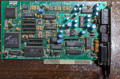

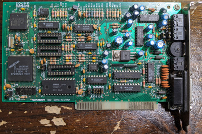

Reply 33230 of 53165, by cyclone3d
mpe wrote on 2020-04-01, 21:25:
I have 3 different versions of the Quickshot Sound Machine:
Top: Creative and Quickshot branding - lower edge - with CMS sockets and socketed OPL2
Middle: Quickshot branded - with CMS sockets
Bottom: Quickshot branded - without CMS sockets

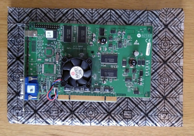

Reply 33232 of 53165, by blurks
Not much recently, but this Voodoo4 4500 PCI falsely advertised as a Voodoo3 for the price of a Voodoo2 I just couldn't let pass.

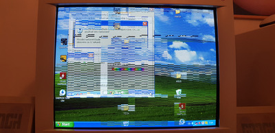

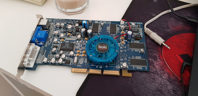

I got myself a Hercules 3D Prophet FDX 8500LE. The seller admitted that it displays artifacts and sold it as non-working for $2; did not bother me, I used to have one back in the day, in fact it was my "first gaming" GPU I bought myself, and I love the way it looks, so I want to frame it. In fact I already have one working in my Athlon XP 1800+ build
However I was wondering, do any of you have any suggestion how to fix this? It would be lovely to have a working backup...
Works fine in character mode on startup

Reply 33237 of 53165, by appiah4
The checkered nature of the artifacts is a pointer to ram issues more than with the GPU itself.
Reply 33238 of 53165, by derSammler
Can you explain this? If video RAM is bad, there should be garbled pixels instead, not shifted blocks. Such a ordered pattern hints to an address line not working correctly, and those are coming from the video chip. Now of course, a RAM chip may also just not react on an address line, but BGA chips are prone to fail at their solder joins, while RAM chips are normally quite reliable.
Reply 33239 of 53165, by appiah4
derSammler wrote on 2020-04-03, 09:36:
Not in my experience.
