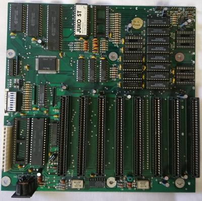

Here is a little game of Find the problem.
My new XT board just arrived, it was advertised as working.
My only question: why would anybody do that?

Is it working after correcting the problem? Somebody might have been curious and not knowing what they were doing?
They did not test it though 😜

I just tried it in a different XT board and the CPU is fine. Swapped the CPU and the board is not starting at all. Tried this CPU, nothing.
The Juko board is dead. I can only think about one thing: He installed the CPU incorrectly to make it seem like I screwed something up that made the motherboard go bad. But I religiously check IC orientations because I screwed it up once in the past and learned my lesson.
Already wrote to the seller to explain this to me.
The fact that the CPU is working suggests that it was not turned on after it was incorrectly installed.

The CPU is inserted the wrong way?
Yes. It seems like the seller tried to pull a little trick on me.

With these CPUs, not even the CPU itself will die. It only has a single GND and VCC pin, which are swapped when the CPU is inserted the wrong way. No current will flow in this case and no short is caused either.
The board was probably dead from the outset.

From my understanding the current will flow the reverse way when exchanging VCC and GND?
I inserted an EEPROM several times the wrong way. It gets _really_ hot but still worked after that procedure...

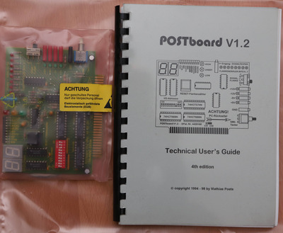

Received this POST card. Never used and comes with a 200 page manual. Seems to have much more features than the China-cards.

yeah, I inserted cache the wrong way (the right way according to the motherboard manufacturer) and they went smoking and are definitely toast after :p
so unless the 8088 has a reverse voltage protection diode I don't think it would survive would it?
ah nice, I wish I had one of those ^^

Or it has an internal fuse that blows temporarily but I'm not sure. Either way I'm not going to test it. 😁
A 41256 RAM definitely burns if it is inserted the wrong way.

No, since a transistor can not have the current flow the other way - it will block it. And early, simple CPUs like the V20 are made of transistors only. The CPU may get warm since some leaking current still creates heat, but unless you leave it in that state for a long time, it won't cause damage.
