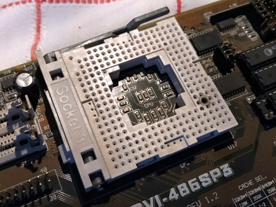

I had happily bought a very cheap ASUS PVI-486SP3 PCI/VLB Socket 3 motherboard, but once I received it I noticed something that I hadn't when looking at the item's potato photos, a burnt pin on the CPU socket. So tell me Vogons, does this mean there is no hope for this board? Could it be just the plastc that's burnt? Would a socket change be in order? Or would it be a lost cause regardless?

It kinda looks like some one got bored with a soldering iron and jammed it into the hole. Is there any burnt traces or other damage to the rest of the board?

Not on initial viewing. It seemed to me şike someone inserted a CPU wrong way around and burned the CPU which may have scorched the socket maybe?

I can do the trace continuity from the pin's solder pad, that's easy. My real issue is not knowing what kind of a disaster is inside the socket..
How easy are these sockets to open up? How does one go about it?
Reply 35167 of 40040, by imi
idk how exactly but I do know you can rather easily take the sliding top part off the socket
rotating the CPU counterclockwise would short this pin (TMS) to VCC ...so that seems a likely cause.

I would just go ahead and test it. Way back in the day, I accidentally put a CPU in a 486 board the wrong way and when I powered it up, it actually shot flames out from in-between the CPU and the socket.
Melted the socket to the CPU a bit. Once I was able to get it out, I feared the worst but decided to try putting the CPU in the socket the correct way. Much to my surprise it worked just fine.

I will give it a good thorough clean and do my best to get the scorch mark off the socket, then give it a try with the lamest 486 class CPU I have in my collection.. A DX2-50 or some such practically useless CPU I would think 😀

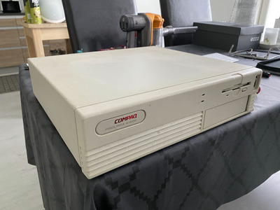

Bought this Compaq Prolinea 4/50S for 66€ including shipping. I don't know if I overpaid, but I have wanted a 486 or 386 desktop system with ISA slots for some time. It has integrated Tseng ET4000/W32i graphics, which I suppose is decent for DOS games. Hard drive is missing, hard drive mounting plate is missing, floppy drive doesn't work, but otherwise it seems to be ok. It is dirty, but after good cleaning, I'm sure it will look very nice 😀

Nice catch! I don't think you overpaid... It's not a bargain either. Just anok price. These machines are generally quite popular.
Floppy drive may just be dirt as well I guess. Clean it and you're probably all set.
For a hard drive a CF card would do perfectly, cost close to nothing and is reliable.
And do yourself a favour: see if you can set the base clock from 25 to 33MHz... The CPU will most probably just be a dx2-66 which is purposely clocked down by intel to fill a market gap 😀
Stuck at 10MHz...

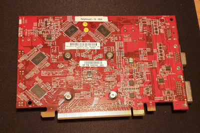

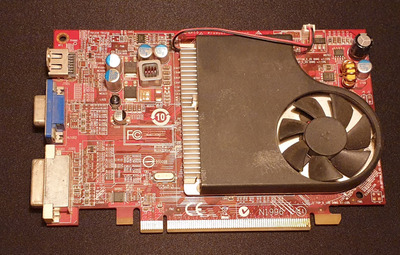

Got this graphic card in a 7 euro lot together with some isa sound cards. Not really sure what this supposed to be. 😅
