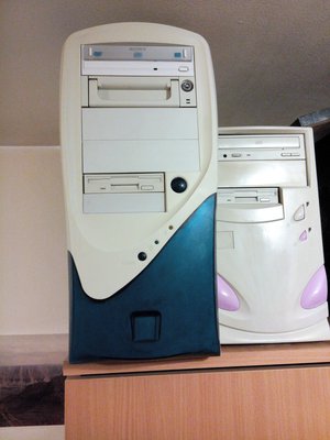

I love the way that case looks - the stickers as well. It's very hard to find vintage looking ATX cases nowadays. Lately I've been setting for cheap chinese black cases of decent quality and design, and when I'm lucky I'll stumble upon something like an older Antec NSK series. For all my searching, I could only find one good looking retro ATX case - the only one in my collection - this thing:
2.58 MiB
5640 views
As you can see, the bay covers are from another case, and they have been bleached using hydrogen peroxide. I'll bleach the case and IDE rack as well, so everything should match up nicely
If we lived in the same country, I'd take that case of your hands. A little hydrogen peroxide 12% hair cream + 2-3 hour sunbath and the yellow will go away. For the pannels I use Policolor white 124 or thin beige primer. I don't even mind the missing bay cover - one could install a white 5.25" IDE Rack or white fan controller to make it look complete and period correct.

Yeah, I've decided to keep the case. One of the problems is that its twisted, the four legs never touch the desk at the same time. I will completely diasassemble it and see if I can bend everything back into place. Not ver easy, it's very thin steel. I love the stickers 😀

Use a mallet if you have one, at least for the bottom of the case. (Well, that's what I'd do)
Reply 7875 of 39964, by HighTreason
I use a piece of old floor board and a lump hammer. The board goes between the hammer and the case.
