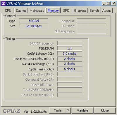

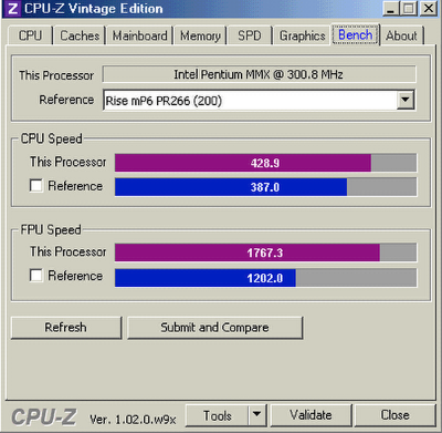

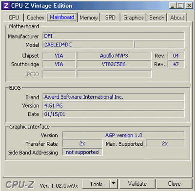

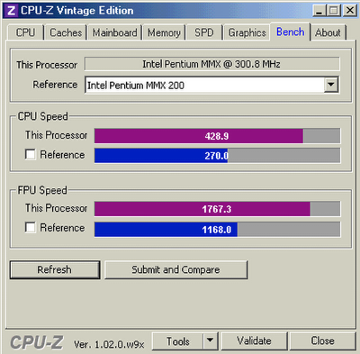

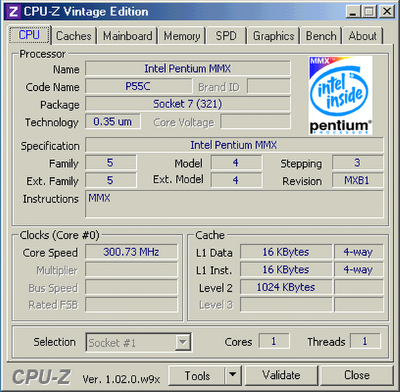

CPU-Z Vintage Edition under Windows ME, also here completely stable with 2,8V VCore (GLQuake with Riva 128ZX/8MB SGRAM and Prime tested):

    compared to Pentium MMX 200 MHz

    compared to Rise mP6 PR266 (200 MHz)
