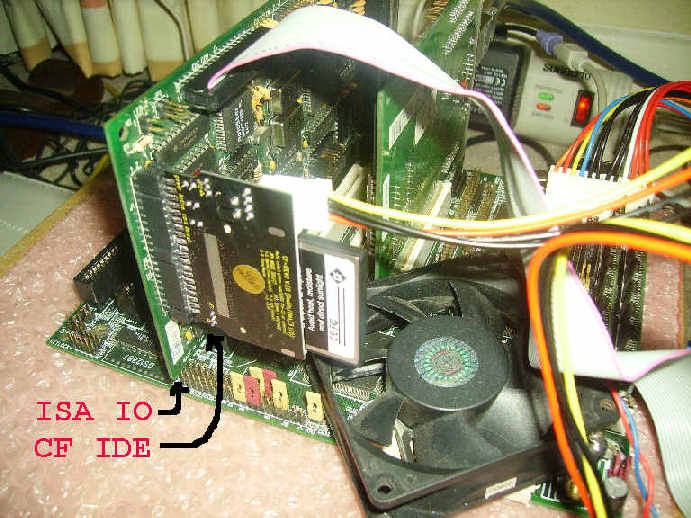

Solved! Following on from my O.P., I have now got a CF IDE device to work successfully on a 486. I did the following to get this to work - I replaced the "top of the range" Transcend 2GB 133x CF card, with a "bottom of the range" FujiFilm 128MB CF card. This card looks like older stock. Probably slower than the 133x Transcend card. Please note that I haven't replaced the CF IDE device (as described in the O.P.), all I've done is replace the CF card.
Now, the 486's BIOS auto detects the "HDD" OK, and I've successfully installed DOS 6.22 on to it.
Reply 29 of 32, by retro games 100
I even got the CF IDE device to work on an ISA-based IO controller card, in a 486 mobo. Please note - it would only work if the mobo's BIOS had its "32-bit data transfer" field set to Disabled. Booting up time = about 1 second, for DOS 6.22.
PS - do you like my new jumpers? 😎
