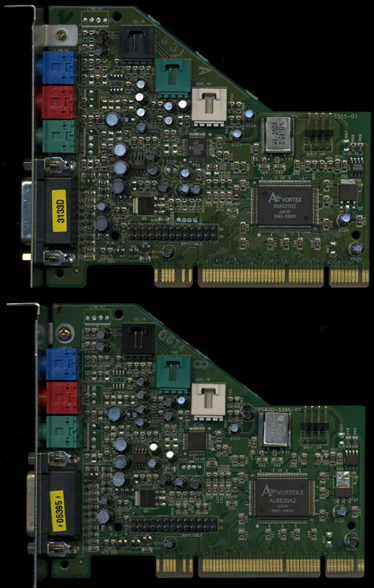

Here is an illustration showing the similarity of the Turtle Beach Vortex boards, tricky ain't it?:
    114.42 KiB
    8073 views
    Vortex 1 (Top) an 2(Bottom) on Turtle Beach Montego PCB.

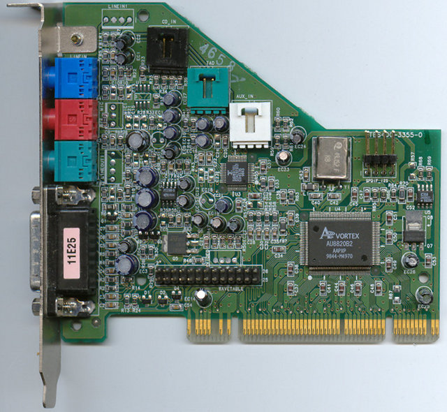

Here's a scan of my Dell-OEM TB Montego A3Dxstream Vortex 1 card. It's a slim little thing. Works great with a DB and sounds good. It came with a Dell Dimension P2-400 in january '99.
Considering how few A3D 2.0 games there are, I don't think you lose much by having Vortex1. It's definitely still got that Aureal 3D quality. I never realized Jedi Knight had A3D support until the other day. 😀

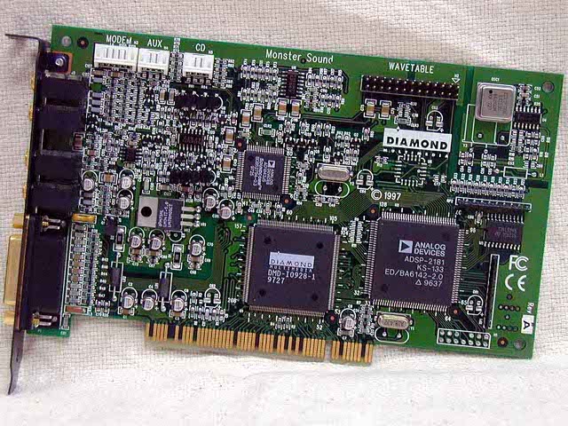

Vortex 1 isn't even the first gen of A3D audio you know. Earlier Aureal 3D sound can be heard from cards like the older Diamond Monster Sounds (MX100, M80, MX200). They used a DSP to do the effects instead of an Aureal ASIC.
There are even some cool chips from ESS that have excellent 3D spatialization, better than Creative and not far off of Aureal. I got a old notebook recently with a ESS Maestro 2 that sounds really amazing actually.
    99.23 KiB
    8047 views
    Monster Sound MX200. Normally has a excellent 4MB Roland-based MIDI DB.
