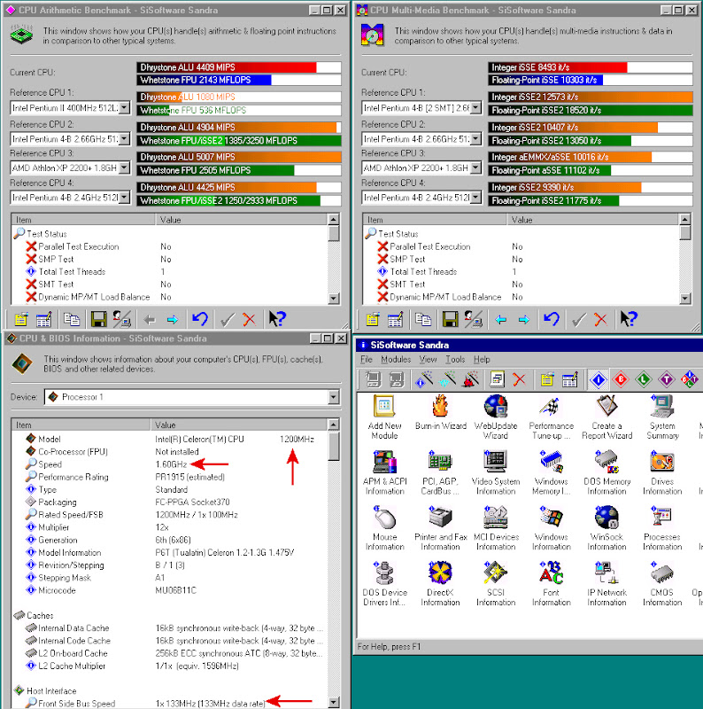

Reply 36 of 77, by retro games 100
Over clocking a Celeron 1200
I have successfully over clocked the mobo to 133 FSB, running a Celeron 1200 GHz (100 -> 133 FSB, 1200 -> 1595 MHz) processor, CPU code SL68P. I set the Powerleap's voltage jumpers to 1.65/1.675, and the system worked flawlessly first time. This is very good news, because it means that the mobo's PCI bus is running at its default setting of 33 MHz, as mentioned above by @buckrogers.
I reran 3DMark 2000, and I got a score of 8597. This is really interesting, because the over clocked Celeron 1.4 GHz CPU (100 -> 120 FSB / 1400 -> 1679 MHz) could only manage a score of 8429. I then over clocked the Geforce3 card, and reran 3DMark 2000. I got a score of 9507. This beats the over clocked Celeron 1.4 GHz with the over clocked GF3 card, which only managed 9184. So, it looks like the Celeron 1200 (100 FSB) is the champ, because of its over clocking versatility.
The following screen shot shows information about the over clocked Celeron (100 -> 133 FSB, 1200 -> 1595 MHz). I used Sandra 2002 Pro.

I decided to push the over clocking to the limit, and adjust the FSB from 100 to 140. Incredibly, the mobo running the Celeron 1.2 GHz CPU was able to get to the desktop, and allow me to run Sandra 2002 Pro. I took a screen shot of it running its tests at 1679 MHz! However, this successful test was overshadowed by the fact that running 3DMark 2000 resulted in failure. When I launched this benchmarking app, I got a BSOD.
I decided to increase the Powerleap's voltage jumpers by one notch, from 1.650/1.675V, to 1.700/1.725V. (The default voltage for this 1.2 GHz processor is just 1.5V). I rebooted, and was able to run 3DMark 2000. However, after a few of its tests, it quit back to the desktop. I guess a 100 -> 140 FSB / 1200 -> 1679 MHz over clock is just too outrageous. However, it's good to know that it nearly worked, because it makes the 100 -> 133 FSB over clock test seem good and stable, which it appeared to be.
