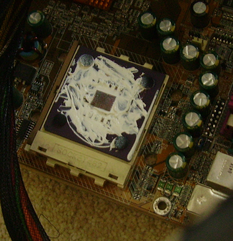

Apart from the blindingly obvious, what strikes you about this image? The winner gets a screw loose from the hull of my spaceship. BTW, it's from a Gigabyte 7IXE4 mobo I'm testing. That "thing" in the picture is a working 😳 Duron 750.
Reply 5 of 24, by gerwin
It looks like an abstract artist was having a blast with the grease.
I would think the grease can shortcut the capacitors on the CPU base. But I am not sure.

Actually, that was my rather poor photography. (The flash bulb is broken on the camera.) The board + CPU are both alive! I've only just removed the heatsink after buying this board about 6 months ago on ebay, and was startled to see what was underneath it! 😉

There is conductive and non-conductive thermal grease (those with silver in the name maybe). For me this looks like the latter on the photo so no problem there.

Another interesting point of discussion is where exactly to put the paste: just on the CPU, or on the CPU and also on the heatsink? Perhaps the best method is to put it very thinly on to both surfaces?
Reply 13 of 24, by HunterZ
I avoid putting it on the heatsink because it can be hard to predict the exact CPU contact area. I find it's better to just put enough extra on the CPU to fill in gaps in the heatsink - which isn't much.
On my latest system (Intel Core i7-860), I followed the instructions included with my Noctua cooler: I put a small bead of the included thermal compound on the middle of the CPU and just made sure to twist the heatsink back and forth slightly before locking it down to spread it that way.
On my previous desktop (AMD Athlon64 X2) I put a little Arctic Silver on the middle of the CPU and pre-spread it to cover the entire CPU before applying the heatsink. I did this because I was worried about it leaking out onto the surrounding capacitors, as Arctic Silver is conductive.

I did that with Arctic Silver 5 once just to prove that it wasn't conductive to the morons who can't be bothered to read AS's web page and just keep repeating the same forum hearsay. 😀
I slathered it all over the exposed capacitors and the various bridges. I then proceeded to run Prime95 on it for a few hours.
In the past, they didn't claim electrical non-conductivity (except for their Ceramique compound). It looks like they're now splitting hairs and saying that it's capacitive but not outright electrically conductive.
There are probably also other brands out there that are straight-up electrically conductive, so it's best to play it safe.
Reply 16 of 24, by swaaye
They've said "negligible conductivity" since AS1.
http://web.archive.org/web/20001011080937/htt … .com/index.html (2000)
Stick a multimeter into the stuff and measure resistance. You'll get infinite. I slopped it all over the surface of a Thunderbird. All over the capacitors and bridges there. I saw no apparent effect. If you got it into the socket it would probably act as an electrical insulator.
