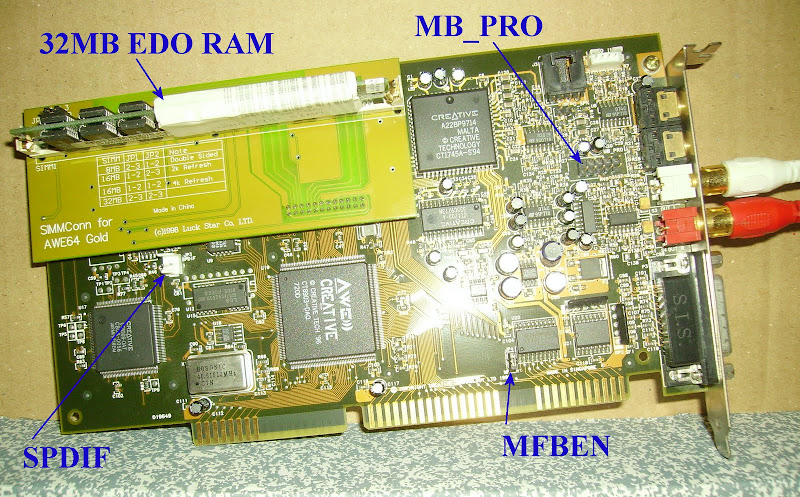

I have received a SIMMConn RAM adapter, for an AWE64 Gold sound card. It seems to work OK.
I have loaded up some of this RAM with an 8MB Chaos sound font, see "2" in image below. I also tried a couple of others: APS SF2, and another much smaller APS sf2.
In the image above, the "1" controls the music volume, when I use a DOS game inside a "command prompt window" - "4". In order for this music to be heard, the bottom checkbox seen at location "3" needs to be ticked.
Questions:
1) It would be fun to test the 32MB SIMM stick to the max. Is there are 28MB bank/font I can download from the net?
2) Once I get the funky tunes working, what is the best method to make a recording - I could then provide a download link for people to listen to it. Should I use SPDIF, as seen in the first image above?
3) What does MB_PRO do? This is the pin arrangement seen in the first image.
4) I have left the jumper MFBEN closed. I guess that is the right thing to do.
As always, thanks a lot people for any advice offered. 😀
IIRC the AWE32's DIAGNOSE.EXE utility will check the RAM for ya. I assume that this utility also comes with the AWE64, but I'm not sure (?). The DIAGNOSE.EXE utility (among other things) has an option to test any SIMMs on an AWE32, so's I'm figuring that it should work on an AWE64 with the adapter as well.
The MB_PRO connector is an external audio connector of sorts. Here's the pinout:
MB_PRO pin connector assignments:
Pin = Description
1 = AGND
2 = KEY
3 = LINE_IN
4 = AGND
5 = LINE-OUT-L
6 = AGND
7 = LINE-OUT-R
8 = MONO-IN
9 = AGND
10 = MIC-IN
The MFBEN jumper need to be closed in order for the AWE32/AWE64's emulated MPU-401 to function. Here's another message with a bit more deatils -> http://queststudios.com/smf/index.php?topic=3092.0 .

Regarding the MB_PRO connector. It's a connector used by Creative support / tech people to test cards. Instead of plugging in the devices the traditional way, they just hook up a cable to this singe port and are done.
The older Sound Blaster cards had a similar port.
