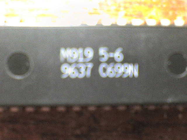

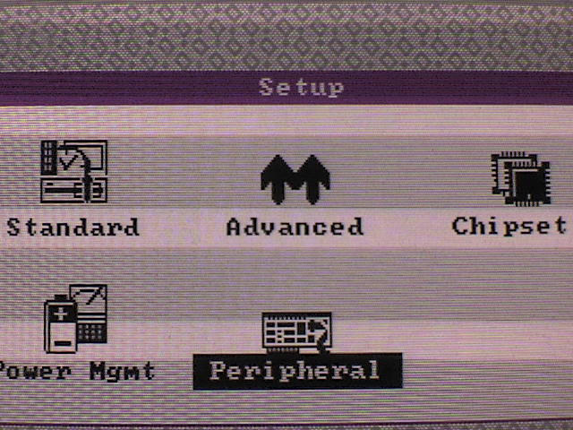

the pictures came now!!!

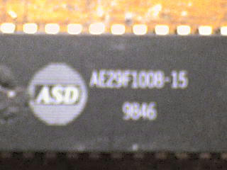

BIOS used to flash M919

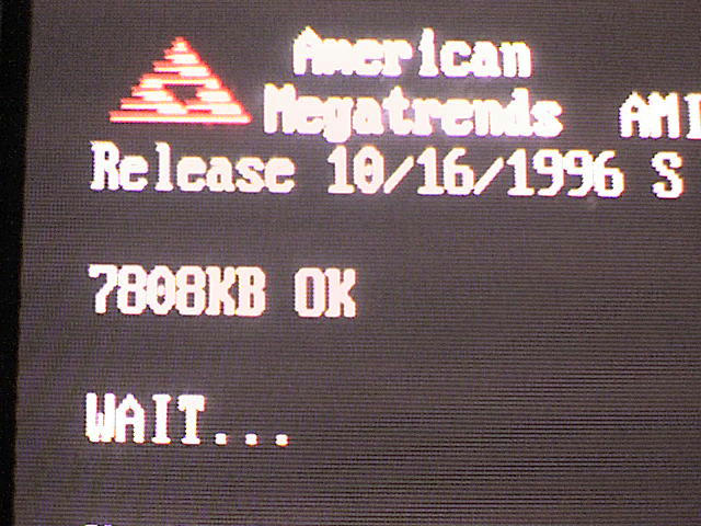

1996 BIOS
1996 BIOS "Plug and Play & BootBlock Supported"

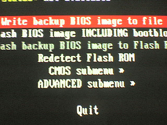

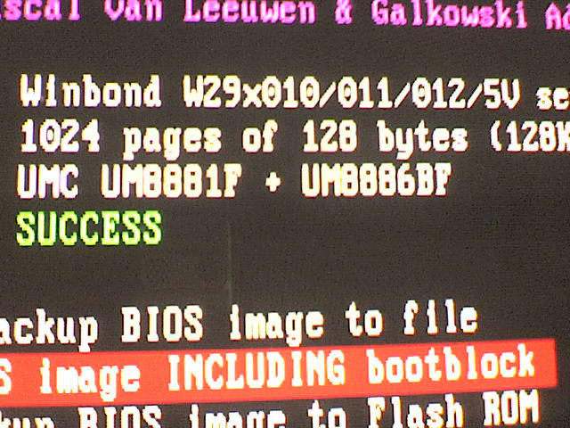

Uniflash options not greyed-out

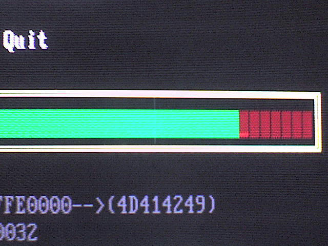

Flashing 1998 BIOS in progress
Almost flashed
Flashed on the M919

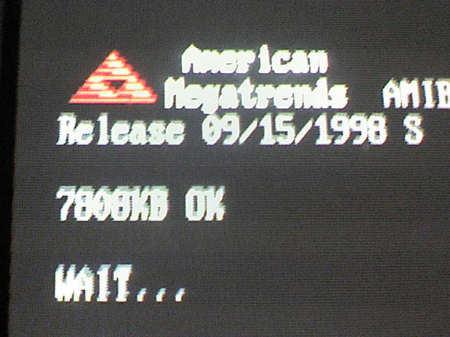

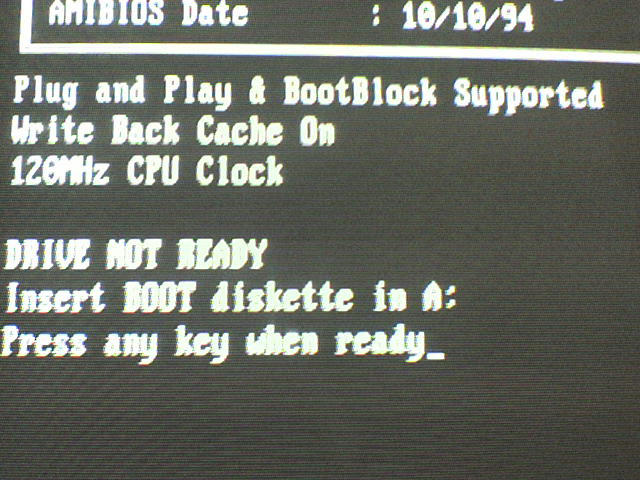

1998 m919 BIOS POST

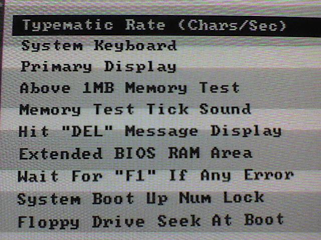

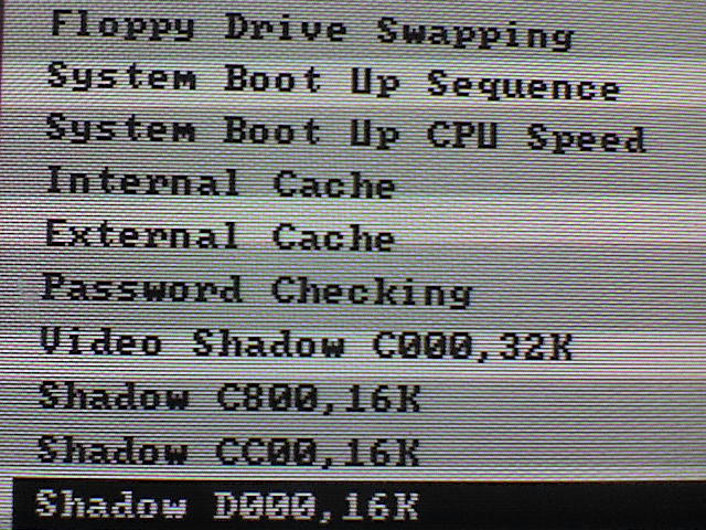

Advanced Setup (1)
Advanced Setup (2)
Advanced Setup (3)

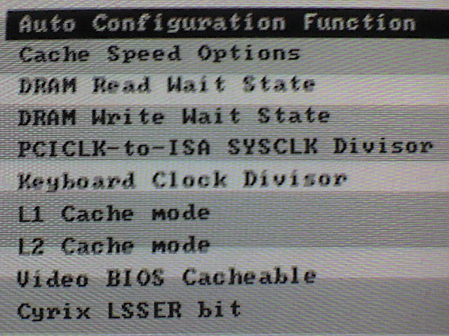

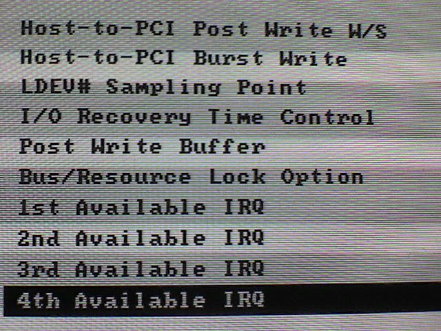

Chipset Setup (1)
Chipset Setup (2)
Chipset Setup (3)

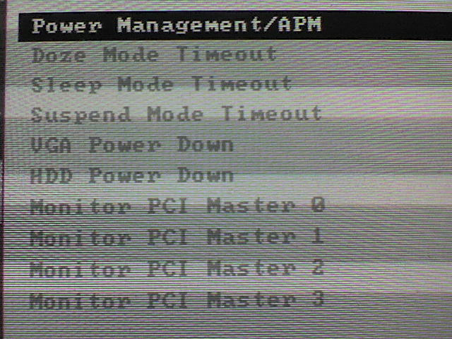

Power MgMt

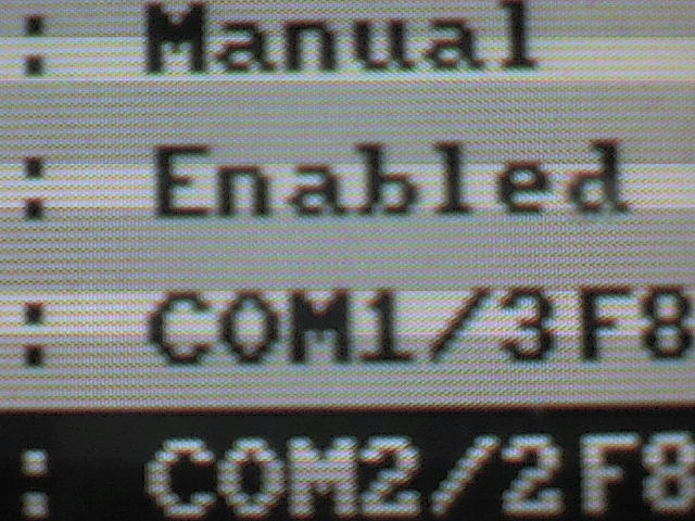

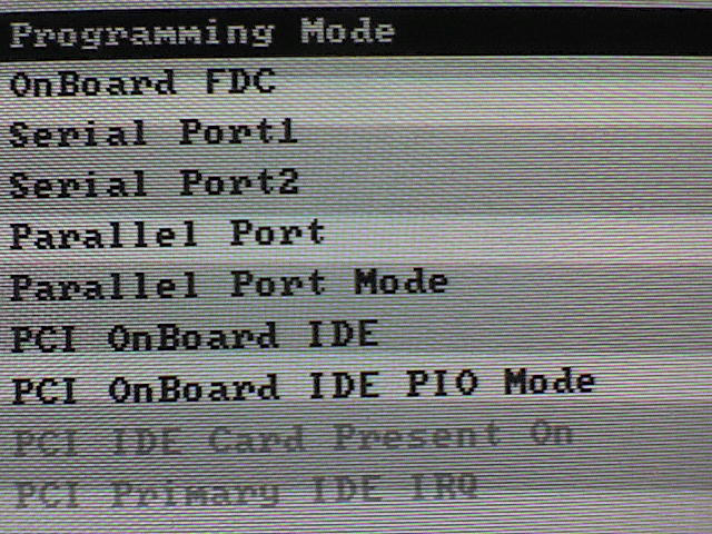

Peripheral Setup (1)
Peripheral Setup (2)

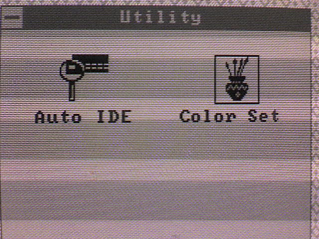

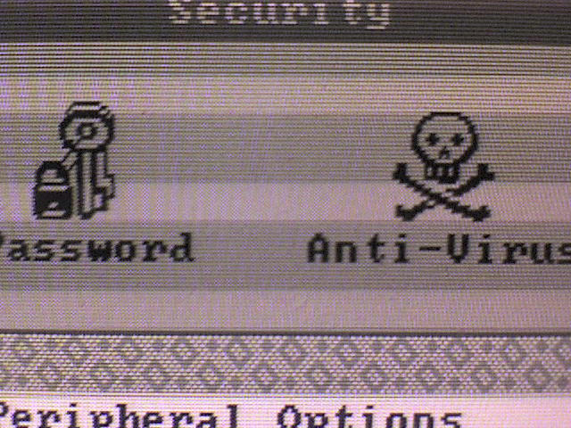

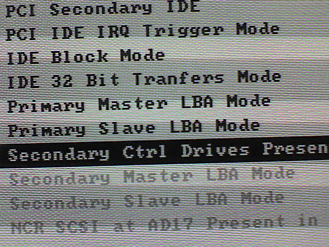

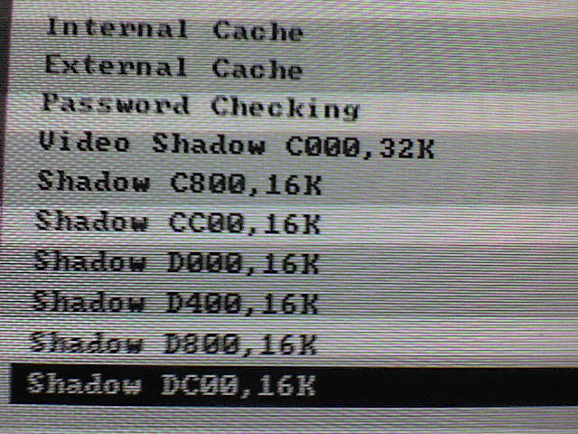

@feipoa
>In this picture i see "NCR SCSI at AD17 Present In" is this thing the one you wondered?

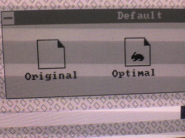

Setup
Utility
Security
Default

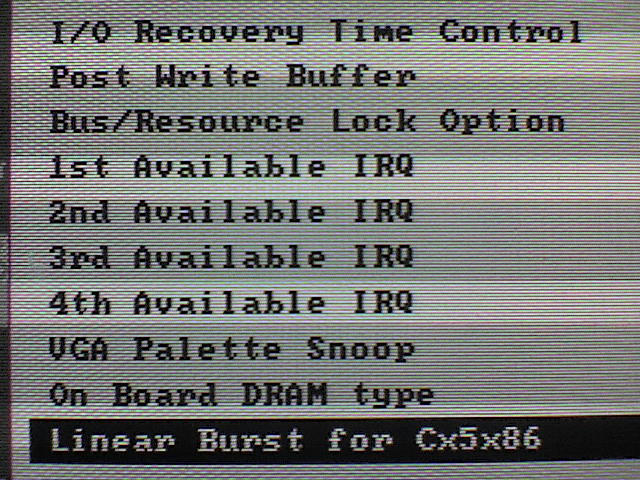

@feipoa
you must change some options in "Peripheral Setup" section for get the Floppy and COM ports working

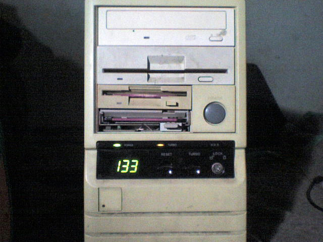

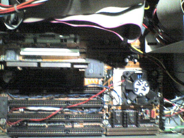

My M919 default BIOS not flash-able
My M919 case

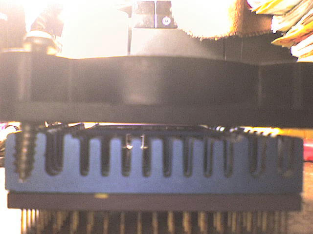

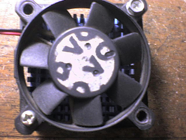

Fan attached to the IBM 5x86
side view
My M919 mobo

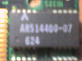

My M919 ram numbers
Full RAM view
Reply 203 of 219, by sebaz_ri
@feipoa
by the way, with the attached fan and all isn´t possible OC the IBM 5x86 😠
in this page i found some information:
http://www.cpu-collection.de/?tn=0&l0=cl&l1=5 … yrix#5x86-120GP
some mentions the Cx 5x86-120 can´t overclock

Reply 204 of 219, by feipoa
It doesn't look like any user-controllable options have changed in the BIOS, but there may be other fixes. Too bad we don't have a revision history. Thank you for the images.
I have never hot-flashed a BIOS before, but I think this is what I'd do,
METHOD A
1) On M919 motherboard with non-flashable BIOS, partially remove the BIOS so that it is just connected.
2) On M919 motherboard with partially connected non-flashable BIOS, boot the system without a boot disk in place and no harddrives. When the system requests the user to insert a diskette, swap out the M919 BIOS and put in the HOT-433 BIOS, then insert a DOS boot diskette.
3) Run the Uniflash utility and flash the BIOS to the M919 1998 revision.
METHOD B
Is it possible to just flash the HOT-433 BIOS inside the HOT-433 with the M919 1998 BIOS? Once flashed, quickly turn off and move the BIOS to the M919 motherboard?
Which method works? Both?

Reply 206 of 219, by sebaz_ri
@feipoa
i think both of these methods must works,but i make this
2) On M919 motherboard with partially connected non-flashable BIOS,set BIOS to boot from floppy
3)Boot from floppy, run Uniflash, remove the non-flasheable BIOS & insert flash-able BIOS
4)In Uniflash press Redetect Flash ROM
5)Flash the BIOS

Well, I flashed into this 9/15/1998 M919 BIOS but have not noticed any fixes with L1 cache of Intel/AMD WB-enabled CPUs, nor fixes with SCSI bus mastering. The only new user-controllable BIOS feature I can find is an option for inputting the address of your NCR SCSI, which is greyed out always, at least for an Adaptec 2940U2W.
I wonder what was fixed? Better yet, I wonder what new bugs PC Chips introduced with this "fix"? Them seem to have removed mouse support in the BIOS, not like anyone really used that feature, but it was a quick way to test mice. I guess I'll check out the 10/10/1996 BIOS.
Reply 209 of 219, by sebaz_ri
udam_u wrote:
Thank you feipoa! I wasn't able to find this bios on the internet. Unfortunately bios on my motherboard has this small window. Have you ever removed award sticker from your bios? If so, what is typed on it? Maybe I can find the same part on one of my damaged motherboards... ^^
I guess you can find flashable BIOS on Pentium mobos, and you should make/try a hot flash
HOT-flash instructions:
1) On motherboard with non-flashable BIOS, partially remove the BIOS so that it is just connected.
2) On motherboard with partially connected non-flashable BIOS,set BIOS to boot from floppy
5)If it detects the BIOS as flash-able, go on flashing the BIOS!
6)Flash the BIOS
Warnings:
See if it detects the bios as 128k or 256k in the organisation section
If it detects as 128k go on!
If it detects as 256k you had to make a few steps before flashing:
1-Copy the file uud0520s.bin (supplied by feipoa) to a floppy
2-Boot using a boot disk
3-remove the boot disk and insert the flash floppy
4-type in the command
copy /b uud0520s.bin+uud0520s.bin bios256.bin
This way, the 128kb BIOS can be programmed into the 256kb chip.
5-flash as normal
Special note:
Don't remove the BIOS with metal tools/screwdriver or things may get wrong with your mobo
