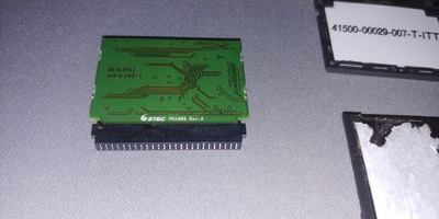

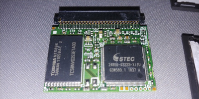

dekkit wrote on 2023-01-18, 14:42:
Example of the cheap cf cards in referring to...
I decided to break open the casing for one of these cheap CF cards (the 512MB one). Here's what they look like including PCB and IC.
PCB Top
1.8 MiB
216 views
Flash RAM = TOSHIBA NT5896 TC58NVG2S3ETA00 (~512MB)
Controller IC = STEC 24850-03333-xI1u
PCB Bottom
1.93 MiB
216 views
The controller looks pretty common for flashdisks (not just CF cards) but was unable to find a download datasheet to see if there is anyway to enable more IDE style features on these things (possibly change the fixed disk in hardware).
Looks like it a similar chip to what is used in the Industrial 44pin IDE drives (ie SLFLD25-2GM1UI)
