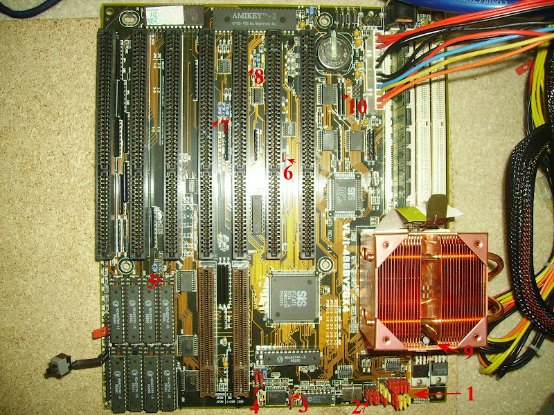

Good news: the replacement BIOS chip has arrived, and it works! The BIOS POST screen correctly identifies the P75 CPU. However, I am still having the same problem as before - that is, when the BIOS POST "table of system resources" is displayed on the screen, the system stops and freezes. I don't see the line of text on the screen that says "Starting MS-DOS..." I am sure this is a mobo jumper problem.
*Please* can someone double-check my jumper settings? Thanks very much in advance! 😀
1
JP16 1-2, 4-5
JP17 1-2, 5-6
JP18 1-2, 5-6
JP19 1-2, 3-4, 5-6
JP20 1-2
JP21 3-4
JP22 2-3, 4-5
2
JP23 2-3
JP24 2-3
JP25 2-3
3
JP2? D for Delay
4
JP27 1-2
JP28 2-3
JP29 1-2
5
JP13
JP14 1-2
6
JP11 Intel
7
JP8 2-3
JP9 1-2
JP10 2-3
8
JP5 2-3
JP6 1-2
JP7 2-3
9
Looking down at the board, this is exactly what I see:
0X
0X
00
X = jumper, 0 = no jumper
10
No jumpers
Thanks very much for any help on this. I'm nearly there, I'm sure I am!
Reply 63 of 79, by retro games 100
In the jumper area labelled 1 above, I changed jumper JP21 to 2-3 (from 3-4). This sets the CPU's internal L1 cache to write-through, and not write-back. This setting allows me to successfully get to the C:\ prompt. Understandably however, I want to activate the CPU's L1 write-back cache, but if I set the jumper JP21 back to 3-4, I cannot get DOS to boot up. The BIOS POST screen freezes after the "system resources" table is displayed.
Reply 64 of 79, by Tetrium
Might it be possible this board won't support certain cpu's with WB and only in WT?
I remember many boards in those day having troubles with WB cpu's

Reply 65 of 79, by retro games 100
I'm confident that Vogons user BastlerMike has this board running with a P75 using L1 cache in write-back mode. His SpeedSys screen shot showed a good reading for L1, @ 200 MHz system speed.
Reply 67 of 79, by retro games 100
BastlerMike wrote:
I'm sure that setting JP5 to 1-2 will fix your problem 😀
*Thanks a lot* ! 😁 I really appreciate your help. That jumper setting alteration certainly has fixed my problem. Now, with the new BIOS chip, and the new JP5 1-2 setting, I can get on with the fun stuff! 200 MHz in write-back cache mode...I'll post back with my test results!

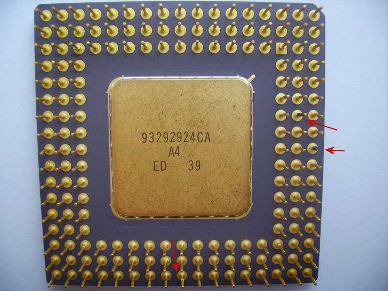

I removed the AMD P75, and installed an Intel DX-50 code SX710. I didn't adjust the mobo's bus speed, which was 50 MHz. Begin Edit: <-- That sentence is incorrect. I meant to say: I adjusted the mobo's bus speed to 50 MHz. End Edit.
The BIOS timings weren't adjusted either - they remained aggressively set. The DX-50 was in bad condition when it arrived. Many pins were bent, and two were severed and blackened! I was amazed it worked. I tested Quake timedemo in DOS, and it worked, although ran slowly.
But the top pic displays your 5x86 ran at 133Mhz 😜
Btw, pic of your DX50 chip's underside? 😁

Reply 77 of 79, by retro games 100
Very well spotted. Thanks a lot for that "error detection" 😀 I meant to say: I adjusted the mobo's bus speed to 50 MHz. Please note that all of the benchmark info above is correct. Just that "explanation line" was wrong.
I will take a pic of the DX50 very soon...
Reply 78 of 79, by retro games 100
Alrighty! 😀 The macro mode on my crappy camera seems to be working. I think the trick is to put the subject matter near a window, to get some natural light on it. It stops the flash messing things up.
The 3 arrows show the 2 severed and scorched pins on the right, and a pin that looks like it will snap soon at the bottom.
Reply 79 of 79, by Tetrium
Eek! I'd be afraid to try such a CPU in any of my precious boards 🤣!
