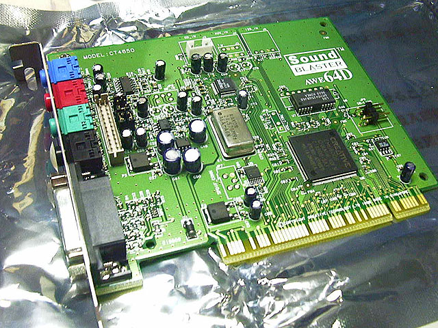

oh yeah they exist. I think they may have been a Dell exclusive though because they are called the AWE64D. They even have a special motherboard connection called SBLink to offer DOS compatibility. This is found on some 440BX mobos.

    pic stolen from da intarwebz

A fourth version that arrived later was designed around the PCI bus. It offers the features of the original ISA AWE64, but it has the PCI interface and is built around an even more integrated ASIC. This made the board even more compact, and thus cheaper to build. Unfortunately, during this card's time, the issue of compatibility with older legacy DOS applications accessing PCI audio cards had not been ideally addressed. Creative created a motherboard port called the "SB-Link" that assisted the PCI bus in working with software that looked for the legacy I/O resources of ISA sound cards. Without this motherboard port, the card was incompatible with DOS software.
AWE64 PCI was later followed by the AWE64D, which was a variant of the PCI AWE64 that was developed for OEMs. It again offered the same feature support as other AWE64 cards, including the DOS support issues. The AWE64D was not quite compatible with AWE64 PCI drivers, however, and had to use separate driver packages.
I think I had one of those sometime, but back then could never get it working because I had no internet connection and couldn´t get the drivers for it... That SB-Link stuff sounds interesting tho, has anyone ever tried it?

But but but BX440 boards have ISA slots...
Anyway, I also wondered about that SB link feature and how reliable it was.

Seems like some motherboards with Intel 810 chipset also had those SB-Link connectors, that might be a good thing since I don´t think I have seen isa slots on those mainboards...
