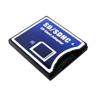

Not so vintage... pre-486 computers have not PCI slots; 486 boards with PCI slots are scarce, too.
I think it would be more useful if was an ISA card. Also, CF cards are dissapearing from the market, so a SD card would be a better option.

Reply 4 of 15, by Old Thrashbarg
CF cards are becoming less popular, but they are still being produced, and they still have pretty wide availability, so I'd consider 'em to still be the best low-cost flash option. SD cards have some significant disadvantages as boot devices... they're typically much slower than CF cards, and because they're not natively ATA compatible, there's an active conversion involved... which means that the adapters are more expensive and the quality of the adapter is much more critical... the cheap Chinese ones tend to be rather flaky.

Reply 5 of 15, by sliderider
Do you think one of these would work?
http://www.amazon.com/Eye-Fi-Compact-Adapter- … l/dp/B001JT708G
Adapts SD cards to fit the CF slots of SLR cameras kind of like the adapters for fitting micro SD cards to full size SD slots.
