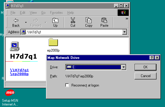

In order to get my W-98SE and W-XP boxes to "see" each other, has it got something to do with network drives? Here is a screenshot from my W98 box. The H7 stuff is what my W98 PC is called. Also, I have set a c:\ subfolder on my HDD called "ep2000p" to be shared.
Also on my W98 box - I ticked the file access box. Good idea?

Reply 52 of 97, by Old Thrashbarg
Assuming I'm understanding your explanation correctly, that's not going to work. To see the ep2000p folder from your XP machine, you'll need to share that folder on the 98 machine, then map the drive from your XP machine. In other words, go onto your XP box, choose 'Map Network Drive" and point it to the \\H7d7q1\ep2000p folder.
Likewise, if you want to view files from your XP box on your 98 box, you'll need to share a folder on the XP box and map the drive from the 98 machine pointed to that folder. Doing it from that direction can be a bit of a pain with permissions, though, so I'd stick with just using your XP box to view shares from your 98 box, and not the other way around.
