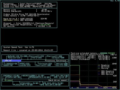

I've had one of these desoldered P266-MMX chips sitting around for years, and I finally got off my ass and decided to try to get it going on an Intel chipset socket7 motherboard.
I have it working in an Asus VX97 at 266MHz, however as everyone already knows the L2 cache doesn't work, because intel made some changes to the CPU. I have seen the posts that claim the only way you can get L2 cache going is to use a board with an Intel TX chipset. So I popped the chip into a QDI Titanium 1B+ board with i430TX. No cigar.

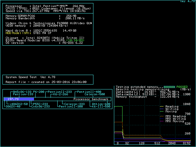

Has anyone else tried TX boards? I think that the only way to get tillamook going with L2 cache is to use the mobile version of the TX chipset.

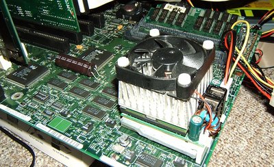

Running 266 MHz Tillamook chip with working L2 cache on Intel Premiere/PCI II a.k.a "Plato"

    Kingston Turbochip adapter assembly
