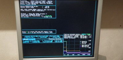

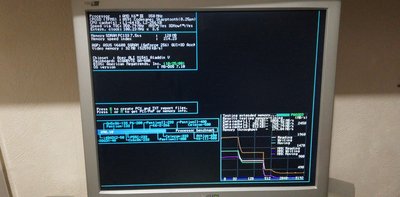

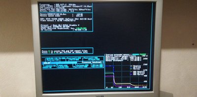

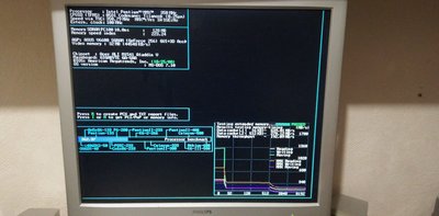

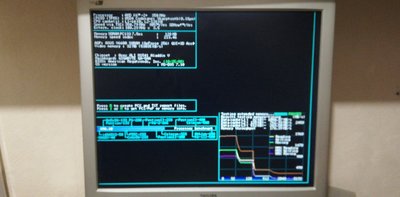

Reply 238 of 505, by meljor
I compared the Intel mmx 233@300mhz 100fsb and the Tillamook at 350mhz and cache seems to work fine and the Tillamook is indeed faster (due to the extra mhz ofcourse but without L2 it would be slower).
Also posted k6-2, k6-2+ and k6-3 at the same 3,5x 100fsb on the same motherboard (Gigabyte Ga-5aa with Ali V chipset, 512kb cache) for a speedsys comparison.
Notice how they all get the same cpu score while the k6-3 is ofcourse the fastest in real live.
EDIT: sorry about the first picture, it's the k6-2+ but it is blurry. Scores are basicly the same as for the k6-3...

Reply 239 of 505, by Nemo1985
I agree with you meljor, the main difference between vanilla mmx and tillamook is that the second has some oboard cache
How can you say that the l2 cache on tillamook is working if it doesn't show up un speedsys, it should show just as it does with k6 plus cpu, don't you think so?
On your screenshots the results for l2 cache (that is the one on the mb) are the same for k6-2, pentium mmx and tillamook.
While the cpu cache gets correctly detected on k6-x+ cpu.
Could you do a benchmark with vanilla mmx and tillamook at the same frequency with quake?
If it shows different numbers cache is detected, so speedsys is wrong, otherwise cache isn't used despite of cpu modding.
