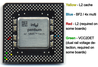

feipoa wrote on 2020-10-19, 01:36:RichB93, that is an interesting discovery about the AL1 pin not being connected to GND, thereby having some MB's forcing the chip into single rail mode. It could explain why many boards don't work with the Tillamook, but does a Tillamook generally not turn on at 3.3V single-rail?
On my board it did work in single rail mode, with the core and I/O using the same 3.3 or 3.5V, depending on the voltage I set. But, in this mode I couldn't drop below those voltages due to the 'auto detect' feature of the board.
I wonder if on other boards they use single rail, with the core and I/O both at the much lower voltages? Could anyone else check this?
