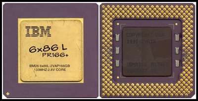

Reply 375 of 405, by mwdmeyer
The 6x86L makes me very sad, fine if you are doing basic windows/office apps but many issues with games and even some apps! Had a PR200+ and "downgraded" back to a Pentium 133.
The MX is much better.
