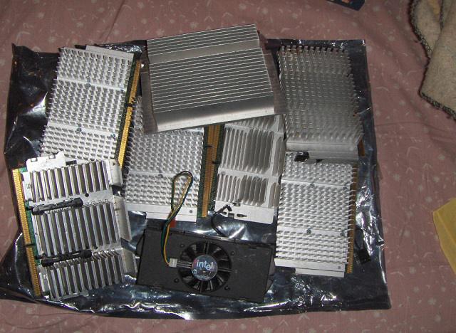

I wonder if one of those large fanless Pentium II OEM heatsinks that Dell/Gateway/etc used would work? As long as it's a SECC1 heatsink I think it can work.
I had a Globalwin VOS32 but gave it away years ago. I do still have an Alpha P3125 though. 😀

    OEM PII junk pile - love the huge heatsinks Slot 1 could fit compared to 370
I guess not, these look like SECC2 coolers.
Reply 6 of 29, by sliderider
You sure all of those are Pentium II heatsinks? The one in the middle looks more like it's the same shape and size as a Slot 2 Xeon.
Reply 7 of 29, by swaaye
I admit I grabbed the photo from a random PII ebay auction.

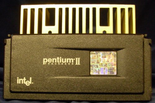

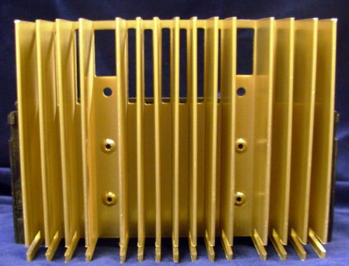

Here's another example. Something like this should have no problem with a Slot A Athlon, assuming it can be attached. This baby is $8 with free shipping and a PII CPU. 😉

Reply 8 of 29, by Maf
The mounting systems in SECC and SECC2 are different, to start with.

Reply 11 of 29, by swaaye
Yes I know. The second photos are of a SECC1 PII. As far as I know, SECC1 heatsinks will fit Slot A and the large fanless OEM heatsinks are as exciting as the best aftermarket coolers. There's quite a variety of these beasts out there too. I love the fanless aspect for silence, but if you attached a fan to one of these the cooling capacity would skyrocket.

Reply 15 of 29, by swaaye
Nope that is the original SECC. SECC2 has mounting holes that go completely through to the back, rounded corners in the plastic and removal of the internal cartridge heatspreader.
