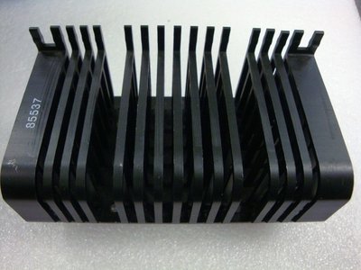

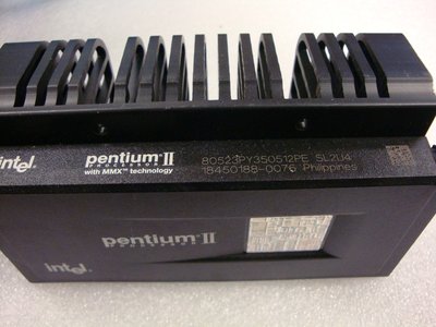

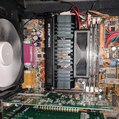

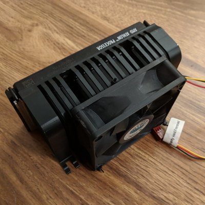

I'm resurrecting this thread because I've done what I suggested those years ago. Pentium II SECC OEM heatsink that was normally fan-less now attached to an Athlon. The Athlon had the usual 5000 RPM 60mm fan equipped cooler that was very noisy. Now it's almost silent.
207.19 KiB
1189 views
246.35 KiB
1189 views
Athlon before and after. Undervolted fan attached with zip ties. These OEM heatsinks attach with screws. The Athlon screw holes were untapped but steel screws don't have much trouble tapping aluminum.

I love seeing all these Orion 1GHz Athlons still up and running. I'd love a golden orb for mine, but swaaye has the right idea. Those giant passive SECC heatsinks with a 80mm or larger fan attached are plentiful, cheap, and effective. Are you monitoring temperatures on that setup? If so, what are you seeing at idle and load?
Reply 27 of 29, by swaaye
Apparently the ASUS K7V needs an external thermistor connected to read CPU temp. And that would just tell you the temp of that area of the heatsink (with unknown accuracy at that). Not very useful.
I've put my finger on the heatsink during some Prime95 and it's quite warm but it isn't burning hot. It seems to be conducting the heat well. The fan seems to move air through it well enough too.

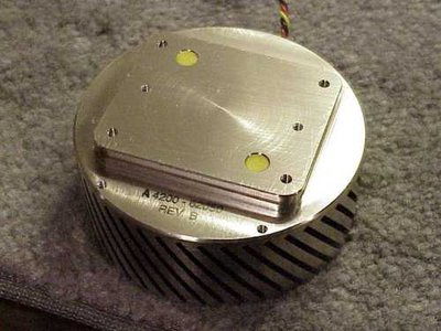

Reply 29 of 29, by Brickpad

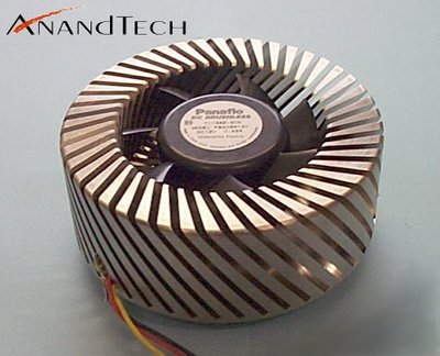

What about the beefy Montac Arctic Circle, a.k.a Panaflo "Orb" ? I still have mine. It's pretty hefty as it's one solid cut piece of aluminum. These were re-purposed HP coolers that were re-milled to attach to Athlon K7s.
