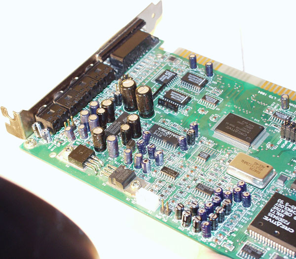

I like that the componentry side of things was mentioned. This does make a huge difference in the way the card sounds.
I installed new capacitors in the OpAmp stage of a Sound Blaster 16 Value, replacing the ancient and surely drift-heavy electrolytics with fresh Panasonic FC and FM's. These are not the best choice, but I wanted a fresh set of caps to liven the card back up. Using my MDR-V700's (24-Ohm) the card now sounded much more powerful. It actually seemed a bit bass-heavy, to be honest.
My plan is to start on a different SB16 and replace the two large 470uF output caps with bipolar electrolytics and bypass them with films. Also, I will replace the two 1uF electrolytics on the input side of the TEA2025B with polypropylene films. (Metallized or otherwise)
I've replaced signal caps on an SbLive! In the past with great results, even causing the sound to be more black (free of noise/hiss) by replacing all the 10uF filter caps along the bottom of the card with fresh, low-impedance electrlytics.

    SB16 Value - ISA
    OpAmp Stage Recapped
