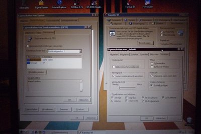

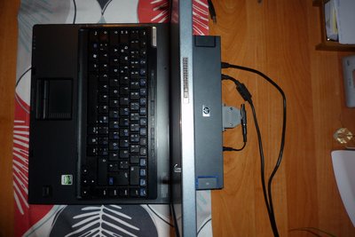

Reply 40 of 64, by dr.zeissler
It's correctly configured.
    1.04 MiB
    1299 views
    751.87 KiB
    1299 views
Retro-Gamer 😀PowerMac 6100-66/Houdini 486/66 - G4 Cube 450/Rage128pro OS9.0.1 - Macintosh LC/Apple IIe Card OS6.0.8 - Acorn A4000 Archimedes - Unisys CWD 486/66 + Aztech Washington
Reply 41 of 64, by Jo22
Yup, looks fine. Sorry then, no idea what's wrong.
Maybe other forum members do have any idea what to do ? My knowlegde about Win98 isn't as in-depth as of them.
If this was about Win 3.x or XP, I'd probably recommend you to use Standard Mode instead or to install porttalk.
Even for OS/2 I could have given you a little tip here and there. But Win98..

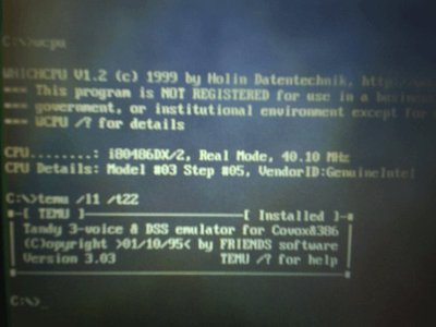

Reply 42 of 64, by Jo22
squareguy wrote:
That is one of the coolest things I have seen in a long while. I was really surprised by the sound!
And it gets even better! 😁 There's a little TSR driver which can provide Tandy 3-voice and Sound Source support.
So you can enjoy these catchy tunes on your self-made Covox plug. Sound quality is nice for what it is.
Here's a sample for you. It was made with my old laptop along with a sluttishly made Covox clone.
The quality isn't the best, since my DAC only uses an approximation of what should be the proper resistor values.
The driver is also attached, since it is small and free.
Have fun!

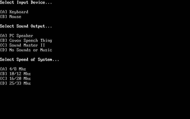

Reply 53 of 64, by Jo22
Ozzuneoj wrote:
Just out of curiosity, would the Covox Speech Thing be at all appropriate for an IBM 5150 with a 7.16Mhz 286 upgrade and EGA graphics? On the list of Covox\Disney supported games on Mobygames, I see that they are all from '89 or '90 and later... which I'm thinking is pushing it for such an old system, but I have been curious about getting better sound quality without having to add a sound card (all expansion slots are full).
It should fit, I think. It was originally released circa '86, so it is a period-correct piece of hardware.
One of my favorite games, the Last-Half of Darkness, also supported the Covox DACs.
And the original release from '89 supported EGA graphics (withouth the "tendril plant" frame).
Maybe the "VGA graphics" version also still works in EGA mode (it did so in DOSBox).
Last Half of Darkness + Covox Speech Thing + DOSBox 0.73
http://www.mobygames.com/game/dos/last-half-o … ess/screenshots
http://playdosgamesonline.com/last-half-of-darkness.html
2.29 KiB
1041 views
Covox support
13.66 KiB
1041 views
EGA version '89
