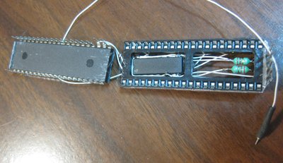

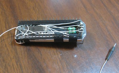

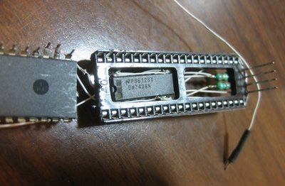

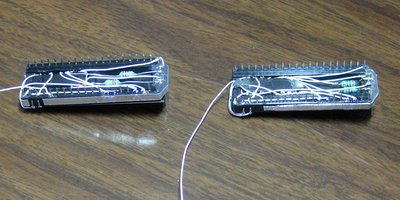

Keropi, attached is a rough sketch of how I wired up the 7406 inside a DIP-40 socket. As it sounds like you just want a rough test to see if your motherboard will work, you can probably wire this up on a breadboard as I did early on in this thread. The drawings in the PDF should allow anyone with a soldering iron to assemble this module in the fashion I did it. I have not double-checked the PDF drawings yet, so there could be mistakes. I'll be checking it when I start to assemble my second module.
Here is a very rough wiring diagram done in pencil. When I am referring to KBC socket, I am referring to the DIP-40 KBC socket as part of my module, not the DIP-40 KBC socket on your motherboard. Of course, you can also offset the header some, but depending on the motherboard you install this into, there might not be room.
Feipoa_native_ps2_module.pdf
213.63 KiB
189 downloads
And some visual aid for those who want to assemble the module how I did it. The header is JB welded to the DIP-40 socket. You must use a long header because the mouse header cable won't fit between the KBC and the header when the KBC is inserted. e.g. digikey part # 609-3490-ND. The two green components are the inductors. The 2 capacitors and 2 resistors are SMD and probably not visible.

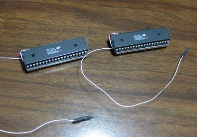

Reply 233 of 543, by feipoa
I finished my second KBC-PS2 module. Works fine. Unfortunately, I plugged the module in backwards on a motherboard (dim lighting). The 30 AWG wire acted as a fuse and separated, however, the KBC died in the process. I replaced the KBC and the module works fine now, but that was my last KBC chip.
I went on eBay looking for the HOLTEK HT6542B or an AMIKEY-2 and could not beleive how much these are going for right now. HOLTEK shipped from USA is $28, or shipped from Hong Kong is $13. A few years ago, I bought mine for $4 each. Where are you all getting your PS2-enabled keyboard controller chips and how much? I don't really want to order from China because packages have been taking more than 4 months to arrive.
