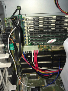

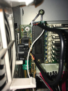

Many thanks to Rio444, maxtherabbit and everyone else for this project. My "386SX Ver 2.0" board is now running with working PS2 mouse with a P8042AHP keyboard controller (the original didn't work with the mod) and PS2suppc.com.
So far, this is the only board that fits the adapter without having a problem or not fitting, but I'll try it on some of my other 386 and 486 systems soon.
I can try it out with my Belkin Omniview SE / Pro (F1D104-OSD/F1D102) if needed. How long does it take to cause problems for other people's setups?

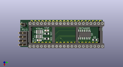

Reply 376 of 543, by maxtherabbit
Here is rev 2 of the interposer board. Designed my own circuit this time using a 7406 inverter IC instead of discreet transistors.
74.37 KiB
1579 views
GPL-2.0-or-later
Reply 378 of 543, by maxtherabbit
Paar wrote on 2022-03-28, 15:36:
How high is it? Will it interfere with an ISA card?
if you build it as pictured with the socket and long headers, yes
however you can solder the KBC to the interposer and use extra short headers and solder it directly to the motherboard, making the whole stack only about 3-4mm taller than the KBC alone - which will clear the majority of cards easily
Reply 379 of 543, by Paar
In that case it could be better to place all the components on the bottom of the board to get another mm or so. Will probably need to modify it to be usable with my board. The prospect of getting native PS2 support with 486 is a strong one.
