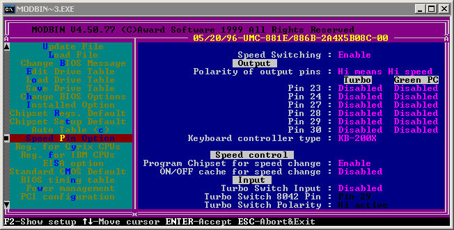

We should probably also note which KBC's won't work with this mod. I can confirm that Winbond's keyboard controller, W83C42, does not work. It originally came with the DTK PKM-0033S.
What KBC pin is the BIOS using for the turbo switch? The PS/2 mouse adaption uses KBC pins 23, 24, 27, and 28. Perhaps your BIOS is wanting to use one of these pins for the turbo feature? Can you use AMISetup to set these pins as disabled for turbo, similar to how Modbin does it (see attachment)?
    15.08 KiB
    1014 views
Reply 59 of 374, by Anonymous Coward
I already tried disabling the turbo functions using AMISETUP, but it didn't seem to make a difference. This is a a bit of a problem since the system doesn't seem to be running at full speed (as far as I can tell). I tried both the Holtek and AMI keyboard controllers, but the behaviour was the same. AMIBCP may be required.
