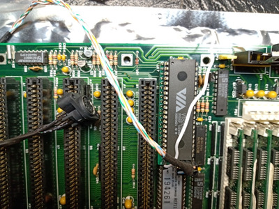

Reply 423 of 543, by mockingbird
maxtherabbit wrote on 2023-08-18, 13:37:
Thank you, it appears pin 24 controls turbo on your board. In your first photo you can see the tiny trace jumpers (the little triangles) that select between pins 23, 24 and 27 with the one for pin 24 connected.
Unfortunately for you, all of those pins are required for the mouse so it's not as simple a matter as changing the jumper. What I would recommend is taking the mod board out and putting the original KBC back in the board. Then, with the system running at full speed, measure the logic level of pin 24. You can also use the keyboard shortcut to de-turbo the machine and verify that pin changed state as a sanity check.
Once you know whether we need to pull pin 24 high or low we can select an appropriate resistor value.
Finally managed to get around to this -- partly because I had no logic probe but also because the one I ordered had large clamps which I eventually replaced with Pomona mini clips when they finally arrived. Thanks for your prescribed diagnostic methodology. I tested thusly: With the board propped up in one hand and a momentary switch in the same hand, I probed pin 24 -- it has a default state of high with turbo on. For the sanity check, I kept the logic probe on the pin while I pressed the momentary switch. With the momentary switch pressed, the turbo LED turns off and the logic level switches to low.
It's a great board if not for this minor quibble, and I don't really need the turbo switching functionality (PS/2 is far more important). Would you kindly please advise on how to proceed with the resistor mod?

Reply 424 of 543, by maxtherabbit
mockingbird wrote on 2023-10-25, 02:02:
ok sure one last measurement - with the machine powered off, and nothing inserted in the KBC socket please measure the resistance between pin 24 at the socket and ground
Reply 425 of 543, by mockingbird
maxtherabbit wrote on 2023-10-25, 02:09:
Thanks. I am getting almost precisely 6 MOhms (megaohms).

Reply 426 of 543, by maxtherabbit
mockingbird wrote on 2023-10-25, 04:17:
hmm that's not quite what I was expecting, you were measuring at the motherboard without the interposer installed , correct?
how about checking it vs the 5V rail?
Reply 427 of 543, by mockingbird
maxtherabbit wrote on 2023-10-25, 13:05:
Let me re-do the measurements for you -- when you said 'nothing' in the socket, you meant without the interposer but I interpreted that to mean without anything at all. Without anything at all it's like before, as well as infinite resistance to 5v.
With only the KB controller IC installed, I get the following:
pin 24 to ground: 8.14 kOhm
pin 24 to Vcc: 6.27 kOhm

Reply 428 of 543, by maxtherabbit
mockingbird wrote on 2023-10-25, 15:19:
Let me re-do the measurements for you -- when you said 'nothing' in the socket, you meant without the interposer but I interpret […]
You were right the first time, I meant nothing at all.
Ok so you can go ahead and solder a 2k resistor from pin 24 on the KBC socket to pin 40 (+5V) on the KBC socket (I'd recommend doing this on the underside of the motherboard) if you'd like, this will probably force turbo on.
To be 100% sure, the best test would be to install the KBC back in the socket (no interposer) and repeat the logic probe on pin 24 test but use the keyboard shortcuts NOT the button. (The shortcuts are CTRL+ALT+PLUS or CTRL+ALT+MINUS)

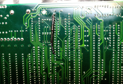

Reply 429 of 543, by mockingbird
maxtherabbit wrote on 2023-10-25, 20:49:
The closest I had to 2kOhms was 2.2K (it was either that or run two 1k parts in series), so I used that:
214.24 KiB
1089 views
The CTRL+ALT+ combo didn't seem to work for this board, so I decided to just go for it:
213.68 KiB
1089 views
Guess what? Not only does it work, BOTH turbo off and on work! I ran landmark 6 and tested with the turbo button to confirm the speed change.
Thanks very much! Perhaps a minor revision is in order for your next PCB to provide for a jumper that connects pin 24 to pin 40 for 386 motherboards that have a UMC chipset. I intend to test a different 386 UMC board as well as a 386 Opti board in the near future as well.

Reply 430 of 543, by maxtherabbit
mockingbird wrote on 2023-10-26, 04:12:
Glad to hear it.
As far as I can tell this is just a one off problem, and even if it were to come up again it might not be pin 24 it just as easily could be one of hte other three. Turbo implementation was unique to each individual motherboard, not chipset specific, so I don't think a PCB revision is practical here.
