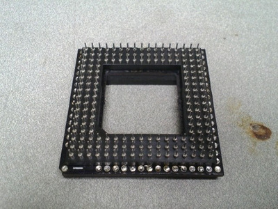

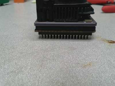

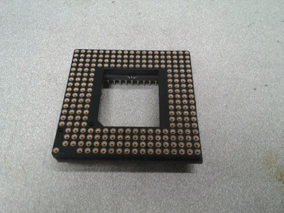

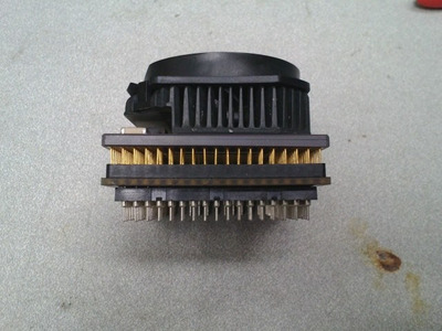

After much delay, here are the shots. and a few explanations.
I used the original Intel datasheets on the 486 as well as the datasheet of the POPD83 Pentium Overdrive. The latter contains a very convenient comparative diagram of pinout differences, what the new ones do and which should be routed where for mismatches. Copied the whole thing in Altium, measured the socket pin dimensions with an electronic caliper, adjusted a few things (hole sizes, etc.) and connected traces as required. Unfortunately write-back cache cannot be enabled as there are a number of write-back-cache-specific signals present on Socket3 which have absolutely no analog on Socket1.
4-layer PCB made by OSHPark, with Ground and VCC planes tying all the power pins together. Holes in the PCB were made large enough to fit around the 'wide' section of the socket pins, making it completely unobtrusive. Outer pins of the Socket3 were cut flat at the neck and soldered in the adapter PCB. Matching pins of the Socket 3 were left full length, their wide sections carefully soldered to the PCB and the remainder of their pins (the full useable length) inserted in the Socket1.
Honestly? Finding the damn sockets was the hardest part of the whole project by a long shot. 😵
From the top:
From the bottom:
From the side, P54D CPU removed:
From the side, CPU inserted:

Sorry to necropost but thought someone might want to see the original images posted by Maeslin
< archive http://web.archive.org/web/20140907075805if_/ of http://oi58.tinypic.com/10z0dpf.jpg, http://oi60.tinypic.com/15sauio.jpg, http://oi61.tinypic.com/ixtb9v.jpg, http://oi57.tinypic.com/5kr1id.jpg >
    68.37 KiB
    916 views
    From the side, P54D CPU:
    61.19 KiB
    916 views
    85.83 KiB
    916 views
    From the top: no cpu
    87.14 KiB
    916 views
    From the bottom: no cpu
