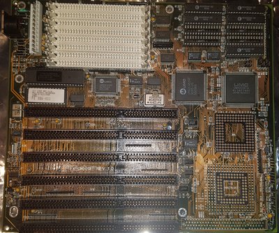

I seem to have different version of that motherboard that only seems to have socket for 386 cpus.
1.89 MiB
458 views
Might make a decent 386 build if I could find a battery holder with a correct connector for it.

I have the 486 version, making it 386 is just a socket soldering away but I can't say I am particularly interested in using this mobo...

I probably wouldn't use one for 486 either because isa video cards are so slow, but for a 386 a ET4000AX card might just be fast enough.
My version doesn't even have any electrolytic capacitors, so that makes it feel like a motherboard that would last a long time.
