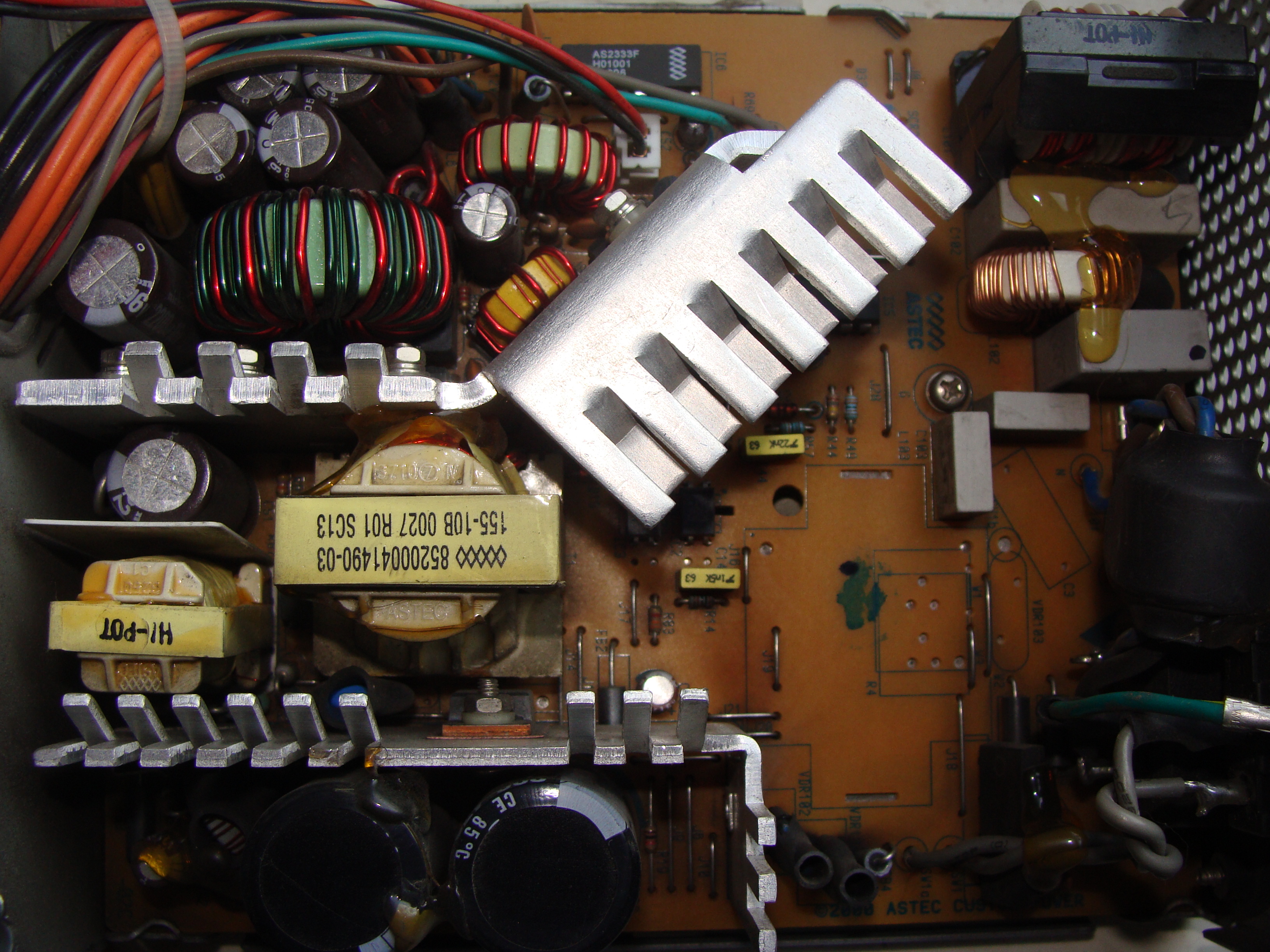

Roger, found pics of its guts at a Polish forum.
Surprisingly well built for such a tiny and venerable PSU! 😎 Quite decent input filtering, thick heatsinks, and good Nichicon jap caps of generous size (2200uF) filtering the output. Good stuff!
I'd stick with it, and just recap if and when the neccessity arose. There's plenty of decent PSU in there for a PIII system.
KT7AGuy wrote:
... If I ever do pull the PSU to conduct a proper inspection, I'm going to turn the fan around so that it ejects hot air out of the case ...
Notice the reason those caps are still alive after 12 years is the good cooling they've been receiving with fresh air directly from the exterior (as opposed to eating hot air from the inside warmed by the CPU). Heat murders electrolytic caps.
