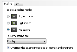

Reply 110 of 278, by James-F
Another way to test a VGA screen (LCD/CRT) on a modern PC with Dosbox:
Disable the GPU scaler:
6.62 KiB
1045 views
Create a custom resolution: 640x400 70Hz (DMT timing):
3.3 KiB
1039 views
Dosbox config:
output=opengl
fullresolution=original
aspect=false
scaler=none
My favorite game to test 70Hz text mode is Supaplex, I can clearly see if 70Hz stutters or not.
These are also the settings when I use my CRT with dosbox on a modern machine.
It switches between 640x480@60Hz and 640x400@70Hz automatically as the game requires.
It also works over DVI and DisplayPort, useful if you have a 144kHz IPS panel.
EDIT: Changed some parameters and verified the settings.
