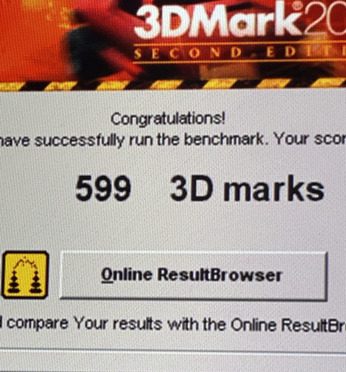

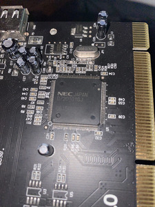

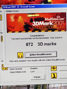

With and without my usb 2.0 card
Which card should I buy to replace it?
I have a 3.0 card but that won’t work in win ME right?
