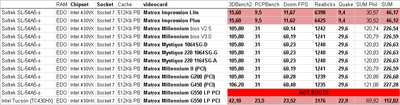

I'm going to make a Matrox PCI VGA benchmarks on P100 and my Soltek SL-54A5-s motherboard and we will see differences. This process will take a few days.

Matrox Millennium, Mystique, Mystique 220, Millennium II and G200 PCI cards are produce very similar benchmark results. G450 PCI is a littlebit faster but this is still a less then 1% difference, so I say Matrox G450 PCI results are also acceptable. Note that G450 PCI will not boot in all motherboards (as I remember none of my 486 boards can boot with the G450 PCI).
19.33 KiB
830 views
P100 Matrox PCI DOS benchmarks
Cards before Matrox Millennium are designed for Windows only and has really weak DOS performance. The G550 LowProfile PCI is a really different desing as G550 AGP (or G450 PCI) and has also a really weak DOS performance.
